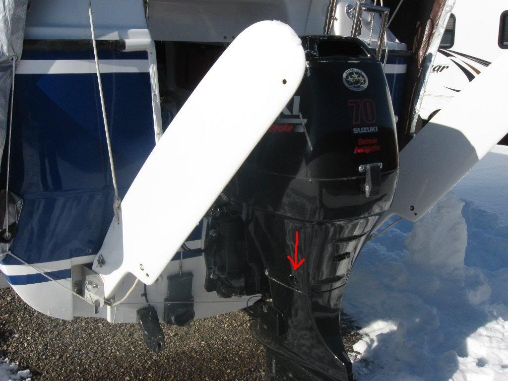

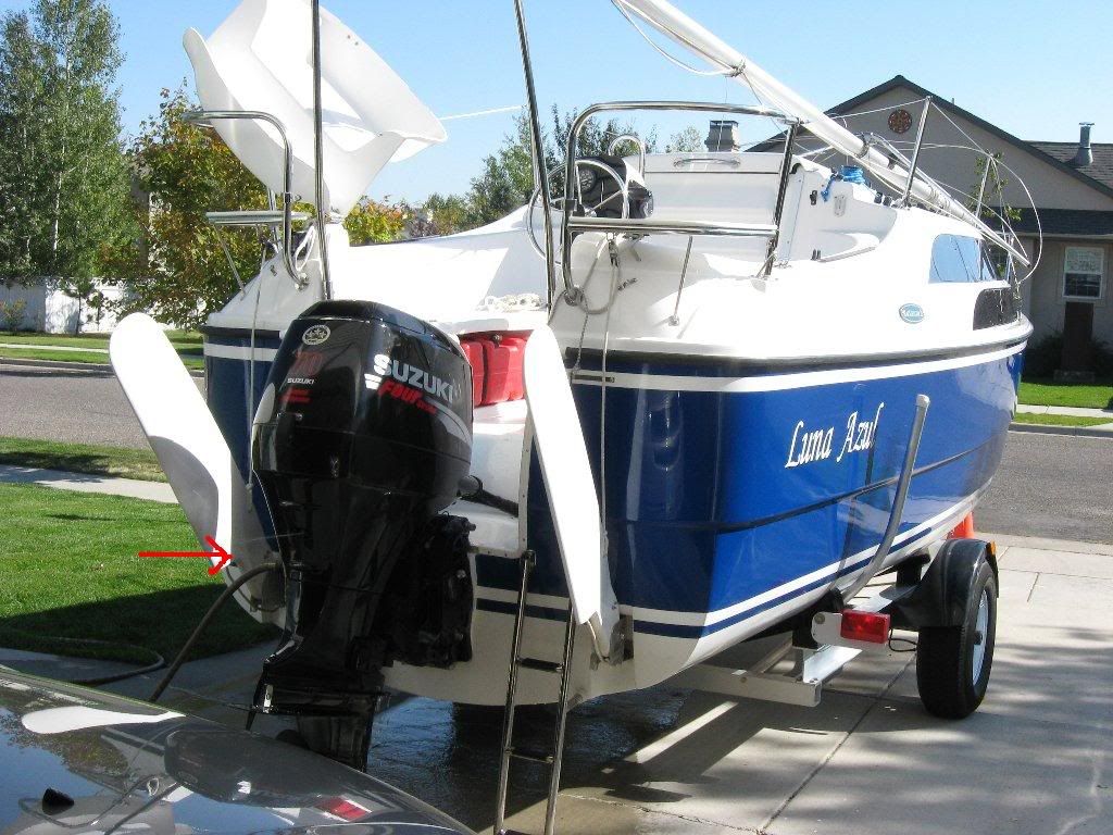

I have an '08 DF-70 but I'm sure it's gotta be the same. I had to take pliers to twist it off, but it's a standard hose port.
(click to enlarge)

Thank you so much for the info, now if I can turn it without breakin it, I will be in business.
Thanks a lot Russ & nice boat
