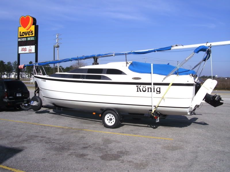

We have a roller furler with a 150 genoa that never comes off the boat. I went with a sock to keep the weight light and allow me to change to a standard jib (someday).
We have towed a lot for the past 3 years (up to 600+miles one way) and always leave the genoa strapped to the mast. i use the boat hook to stiffen the front of the furler. 3 bungees, one at the boat hook handle and base of the furler and 2 more space evenly on the mast. I extend the boat hook about half way out to get the leverage.
No extra parts and everything travels well. I do release the tension on the hoist of the genoa when I winter the unit but otherwise I leave it ready to go.
