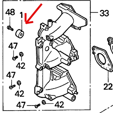

Have you checked all your anodes lately? Are you sure? Ha..... I found a new one for me yesterday, Check this out. Mine was mildly corroded and I ordered a replacement. But I probably would not recommend looking at it unless you have to take off your carburetor intake manifold for some other reason, because the anode is inside the manifold.
12155-ZV5-000 Honda METAL, ANODE Price: $7.06
ANODE

The anode can be seen in the manifold above. It was corroded and there was some damage to the faces of the manifold where it connected to the engine. 7 bolts removed, new gasket needed plus Permatex # 2, all linkage needs to be removed, and fuel hose.
Sorta daunting task for the first time, but doable in about 1 hour....... You do not need to remove the intake silencer and you do not have to disturb the carb settings for idle or synchronization. You should use a digital camera to capture closeups of all linkage and hoses so you do not have to wonder where things go when you reassemble.
My biggest task was scraping the old gasket off. The factory or PO had used permanent gasket dressing (such as Permatex #1) instead of removable dressing.
Caution, in that there is a risk you may may do something dumb that will make you cuss. I almost dropped a nut into the intake manifold opening on the engine while cleaning the face. That would have been a mess. I did not take pictures of how the choke linkage went on and that took me a long time to figure out. Some of the linkage "pops" out of plastic joints, so I guess at some point of brittleness due to age or clumsiness, the joints could break when taking them apart or reinstalling them. Also, be sure to check bolt torque when re-installing and after a few hours of use. I think it was 21 ft lbs, but check it to be sure.

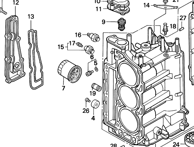

I found another hidden anode. (Item # 4) This one is under what is called the water jacket (item # 12). Manual says to change it when corroded. I'll take a look when I get a chance. Does any other outboard have these hidden anodes and does anyone ever change them or even look at them?
LINK to PART
Re: Anode in Intake manifold - Honda BF50A
Posted: Tue Dec 15, 2009 4:36 pm
by opie
Today, I got around to opening up the port side of the engine to inspect the water anode I spoke of above.
Ugh.... a mess in there. The anode was corroded and I broke a bolt off in the engine getting the cover off.
I had to hacksaw the anode out.
Here is a LINK to my work today...... ( LINK HERE )

I think you should reconsider the opening of the water jacket. Here is why.
What could have been a routine opening and replacement of the anode for me, resulted in my breaking off one of the corroded 6mm bolts in the engine block. If I mangle it while trying to remove it, I could mess up my block. Using a retractor bit, it could break off inside, and those bits are so hard and brittle I would be sunk. And drilling it out and re-tapping to 8mm could weaken the already thin block at that location. Towing the whole thing to a machine shop would better the odds, but not guarantee anything. I could lose my block and I am sure it would be very expensive to replace.
On the other hand, if I had left it alone, it would have cost nothing. I probably would have had 5 to 10 more years of use with religious flushing each time I hauled out. Sure, the heat transfer was less with the muck inside and the bits of anode would have made me continue to clean the water telltale occasionally, but by that time I would be approaching 70 and most likely be looking for a boat that was smaller, bigger or one with a rocker.
Reconsider.
On edit 2 hours later--
I got the bolt out by drilling it out and retapping at 1/4 inch SAE since the 6mm threads were damaged by the drilling.
The above worry is thereby gone but the hard thinking before starting the task is still required.....
