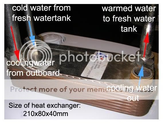

During our planned trip down the Danube to the Black Sea we have to expect to be on the river for longer periods of time without the opportunity to stay overnight in a marina and have a shower there :( . Marinas are very rare in Serbie, Bulgaria and Rumania :( . Now we are thinking about a facility to have warm water for the shower without using electrical energy. Do You think it will be possible to use the cooling water from the outboard (Suzuki 50 HP) to warm up the water for the shower via a heat exchanger. We have one allready and are up to install it :P (see pic). However prior to drill another hole into the hull I´d like to have this matter discussed here. Does anybody have experiance with the use of outboard cooling water for warming the fresh water?

(I am not sure but I think that your device is for large internal diesel sailboat engines, that produce a lot more heat than our outboards...).
Test it before drilling...

We've used a 6 gallon solar shower on most of our trips. It has a water temperature indicator. We've gotten temps of 116 degrees or slightly higher under ideal conditions, but just a few degrees above 100 is more typical. When only in the mid 90's, it doesn't really feel very warm, and my wife won't use it. Lower solar water temps tend to go along with cooler air temps, lower sun angle, etc. Regarding use of outboard cooling water, I'm pretty skeptical. The pee hole discharge seems to be rather low in volume, and when I've used the "ears" to flush my motor, the discharge water has never felt very warm. Considering the limited production rate and marginal temps, I doubt you could produce enough warm water to be useful for showering.

I would love to try running engine water through a copper coil in this tank and see if that would warm the water well enough. Keep Experimenting!
