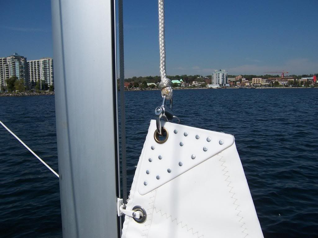

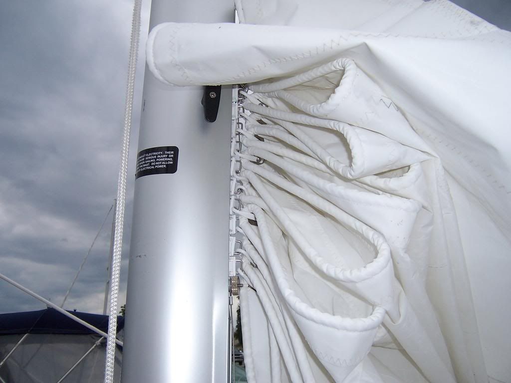

Hi Ellen
They are called sail track slides.
Mine have never popped or broken.
Have sailed in high winds, nil probs.
Here is a pick of mine.....

Thanks beene,beene wrote:Sail slugs...
http://www.sailrite.com/Categories/Slugs
etc....
West Marine also sells them.
I see by your pictures that yours are the nylon and steel type slugs/sliders. The kind we had were all nylon. Guess we will give the nylon & steel type a try, don't want to have that experience again. Thanks for the links
