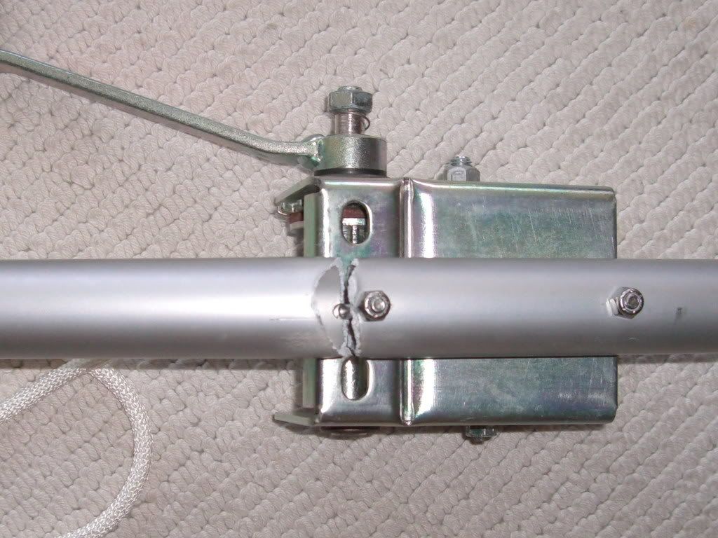

BTW I had a similar incident 2 months ago - my mast came down when lowering it - it was down already about 60 to 70 degrees and fell right into the mast support: the mast raising pole broke right in the middle. I worked it thru my dealer, who was very supportive and had long talks with the factory based on the pictures I sent him. Of course I got a new pole and a can of gelcoat to fix a couple of scratches caused by the broken pole, no further damage. According to my dealer that was the 2nd time that the new mast raising system failed.

And for those interested here is a picture again where my pole broke. With the new one no further issues and I lower/ raise the mast frequently.
