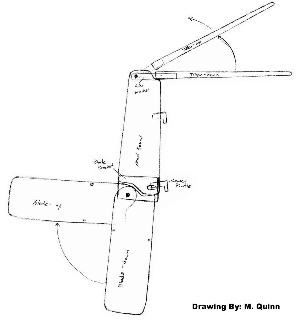

Rudder Drawing for 222
Post by jefscott »
I still could use some help. The rudder and tiller were missing from the 1972 Venture 222 I inherited. I plan on building my own, but am not sure of size, or the hardware availability. The boat still has the hardware that is mounted on the boat, but those pieces mounted on the rudder are gone.
If anyone could send the dimensions/drawings/pictures, it would be greatly appreciated.

Re: Rudder Drawing for 222
Post by ChockFullOnuts22 »
Here are some dimensions from my 1972 V222. My rudder is original from MacGregor, made out of solid wood.
Tiller length: 36"L X 2 5/8"H (at base) X 1 1/2" Thick
Head Board: 37"OAL X 11"+W (at bottom) X 1 1/2" Thick
Blade: 37 5/8"OAL X 11 9/16"W X 1 1/2" Thick
