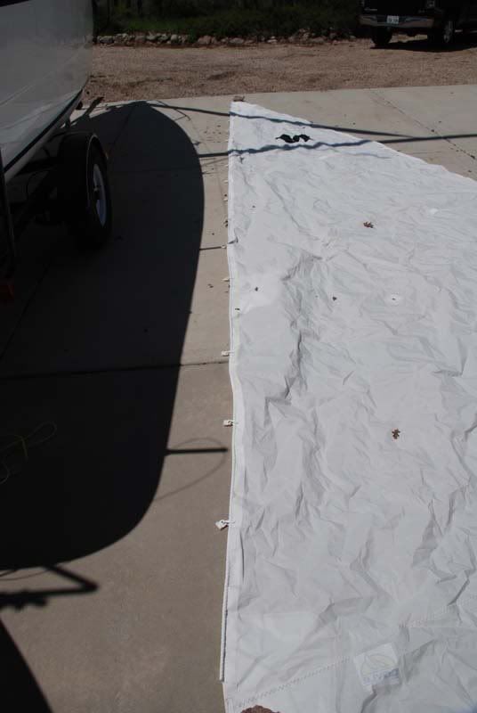

3. Plan your spacing. The kit comes with 15 and the spacing they send you doesn't even come close to working, they say there will be 12 of them used and 3 spares with a 12" spacing. So unless you've put 14' or so sail on that ain't gonna cut it. To get things to work well I had to use all 15. I started 15" from the head, per the included instuctions, then placed every 18" until I got to the reef point. (mine is a stock sail with a single reef)
Looks like this from the head:

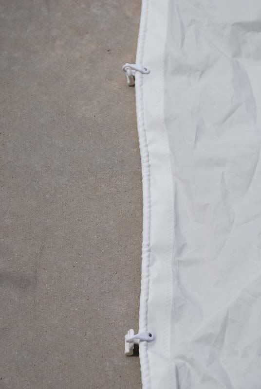

4. I started by laying the shackles next to where I wanted them to end up, and then clipped them on.
Like this:

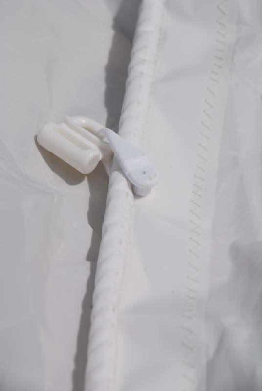

An important thing about attaching them, you ought to put them so the posts that you screw through are right up against the bolt rope, this will prevent the tension from being placed on the sail and will make sure it is on the bolt rope.
Here's a shot:
5. With this spacing I ended up 14" above the reef point. This looked good so I then added the next one 14" below the reef point and then continued the 18" spacing until I had used all the slugs. After everything was installed I tested reefing the sail and it works perfectly to allow reefing without removing the stopper.
