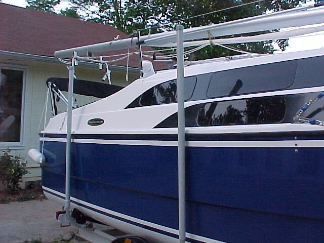

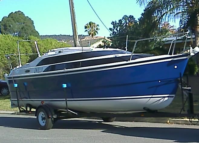

For around $60.00 to $70.00 dollars and a few hours work you can have taller guide post. That will allow you to put the trailer deeper in the water. Which allows you to keep the dagger board down a few inches until you are a lot closer to the trailer before pulling it up completely. Also with the second set of guide post the bow of the boat doesn’t swing sideways once you get half way up on the trailer. Now I look like a pro at the ramp.
