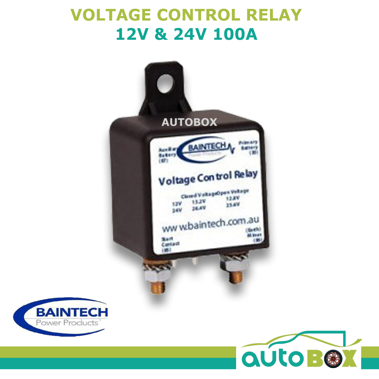

They look like this now in the 21st century :)

Simplest way is with that relay it senses when the start battery is fully charged and then redirects the surplus charge to the house just like your old motor home relay.
Here is one from amazon :)

Yes but your old tech does not just trickle charge as you said, it connects both batteries in parallel while the ignition is on and charges both at the same time, this is not good for the batteries that are possible different chemistries and at different SOCs. Those new smart ones detect when the start battery is full then redirects the alternator flow to the house battery so they both get a good top up independently :).
The old tech works at the expense of the longevity of your batteries. This was probably not as a big deal in a motorhome as you drove for hours at a time to give the batteries a chance to equalise and fully charge. But with a sail boat where the engine is used rarely you risk continually under charging which for a deep cycle battery leads to sulfication which will reduce it's life. Under charging is as bad as overcharging. Which is why I also have solar and put the boat on a 4 stage smart charger when on the trailer or an ac generator when away on the hook.

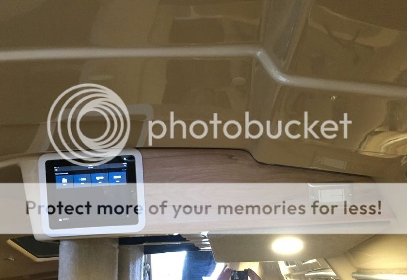

I still need more help - you guys any good as interior designers?? Any of you pink shirt guys or automotive style-shop designers can chime in with some recommendations for me cuz the wife is away at work and can't opine - I just finished the basic shape of the dash board and here is the bracing on the back:
And it sort of goes on the boat like this and I have not put the finish on yet or the rest of the trim:
I say WOOD LOOK cuz it.s made of WOOD :(
And I'm looking at it and I'm saying: "Hmm, still something just not right" "Still missing something . . . "
Mmm, still not enough -
How about . . .
CARBON FIBER!! ? !
So, what do YOU guys prefer? The WOOD LOOK or CARBON FIBER! What do you think?
Re: 'BOAT' needs your help and advice
the wood adds a warmer effect , I used laminated flooring I think it,s called Caribean Mohogany matches the mac mohogany very nicely I also painted the cut edges with black plastic paint to give off a 3 D effect ! :wink:
