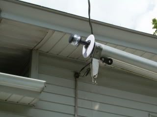

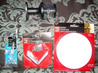

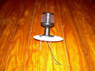

This is how I made my anchor light. All the parts came from wal-mart, except for the light. I used the rear stay to help run the wires up the mast. It was a bit of a pain but the cable helped allot. I also installed a wind indicator on the white plastic circle.
