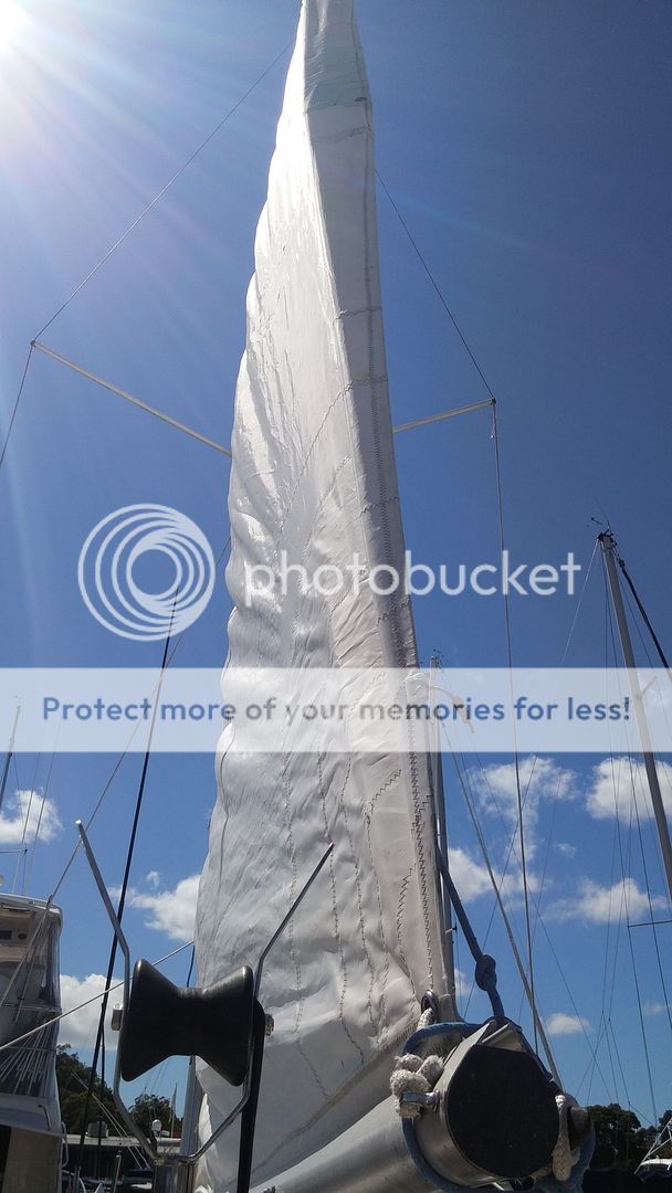

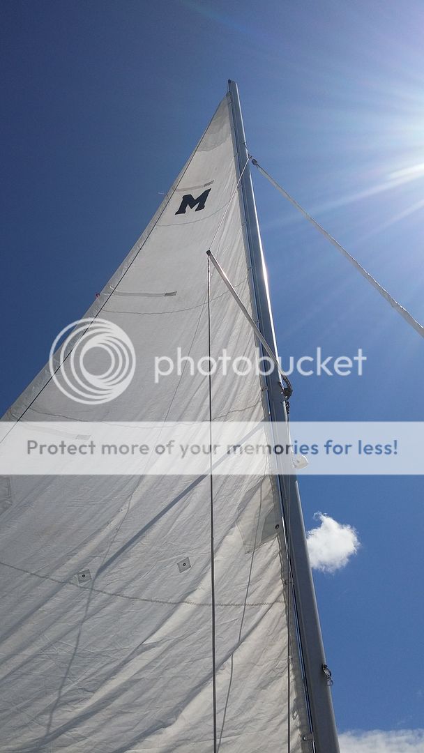

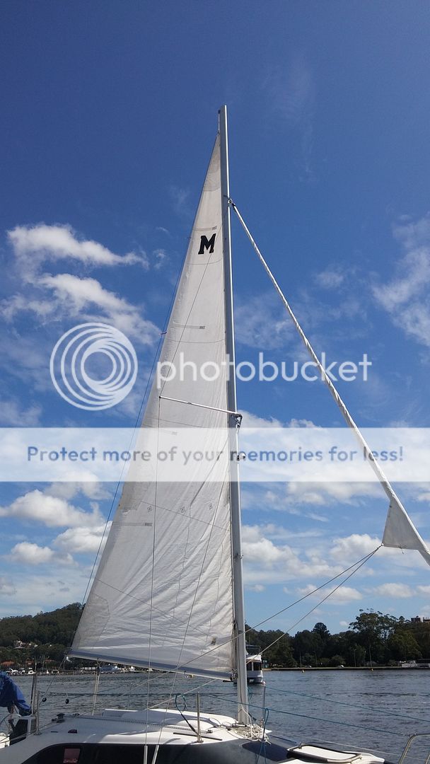

Raised the mast at the Marina .... This raised the attention of the Marina Manager who told me to keep pulling the Haylard "Hard!!!"... I raised the boom (took any tension off the leech) and kept pull the Haylard away for the mast while taking up the slack around the mast cleat. It gave a little more each time which I concluded was the bolt rope gradually stretching but end result was about 8" from the top (Head).
The pics below are with the twist shackle fitted to the tack but I think the one I used was too long and have bought a smaller one since (not tired it yet)..... Whats your thoughts on this?.....

You didn't answer the first question, though I'm guessing that the possibility of the bolt rope stretching would make that a 'yes'.
Tomfoolery wrote:Is the tack fitting tight at the boom when the main is raised? <snip> And if it isn't tight, don't dismiss the possibility that the mast groove is pinched or something else is preventing the bolt rope or top slug from sliding freely.
To answer the second, assuming the first is negative, I'd lower the mast and inspect the slot, and run a slug through it at the top. Eliminate the mechanical possibilities, then look toward the sail itself.
Which looks like a bed sheet. No offense intended. :? I'd cut the threads to the bottom of the bolt rope and see what it does. Mine moved up a lot when I did, and once I fixed the tack to the boom, it looked like a whole 'nuther sail. Not new, not by a long shot, but not so much like a bed sheet any more at least. :wink:
And from the pics, it looks like the battens aren't in it, though that has nothing to do with the bolt rope.

first thing I gotta ask - where are your battens?
neo is right. something is wrong with that sail.
I think Tomfoolery is on the right track - that sail looks like a sail that does not have the tack secured properly. All the things Tomfoolery suggested sound correct. If pulling down on the tack of the sail does not remove the wrinkles I would replace that sail.

According to the wrinkles in your main you need more halyard tension. Also the sail looks like it has a big belly, (blown out). The only real fix is to replace if you want a nice shaped sail.

By the pic, I think the leach is tight and stopping the sail from going up further. Let the boom loose and hoist the sail up some more.

If the boom (main sheet) were tight it would not be able to hang out over the side like that - It appears the main sheet is loose and the boom is free to move.
This is really a puzzle - is it a sail for an X boat maybe? Perhaps the wrong sail?

Tomfoolery wrote:Is the tack fitting tight at the boom when the main is raised? .
It was tight on the boom but loose on the mast. Wanted to get a photo of this but was distracted by the Marina manager (who told me I had to check-out soon!!)
Battens are not in .... because I forgot to put them in lol!! ... But the MainSheet was tight.
Just checked the tracks on the Mast and the boom (inside and out) ... they are perfect.
I hate the idea of cutting stitching .... Do you think I'm wasting my time trying to stretch the bolt rope?
Is the gooseneck designed correct for a Cunningham (Boom Vang)?.... I don't think so :o

When ever I have seen wrinkles like that in the main, it was because the leach is tight before the luff when hoisting.
