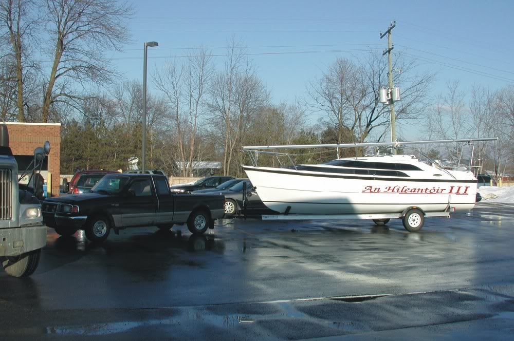

Without getting into a total thread rehash, i think daves numbers on tow ratings underscore the fact that the "tow rating numbers" are more marketing tools than engineering analyses.
Re: Tow Vehicle List
Well me being poor folk I guess I'll just have to stay with my 96 Ford Ranger
Now if I win the lottery a nice new white Ford supercrew F-150 4X4 would be nice
Dave check your trks payload cap. the manual trans is usualy lower so it will also have lighter suspension & may not have any sway bars or just have one on the front axle
