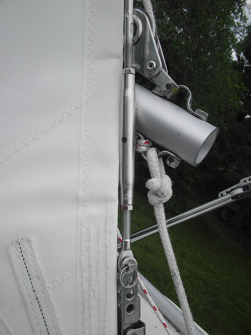

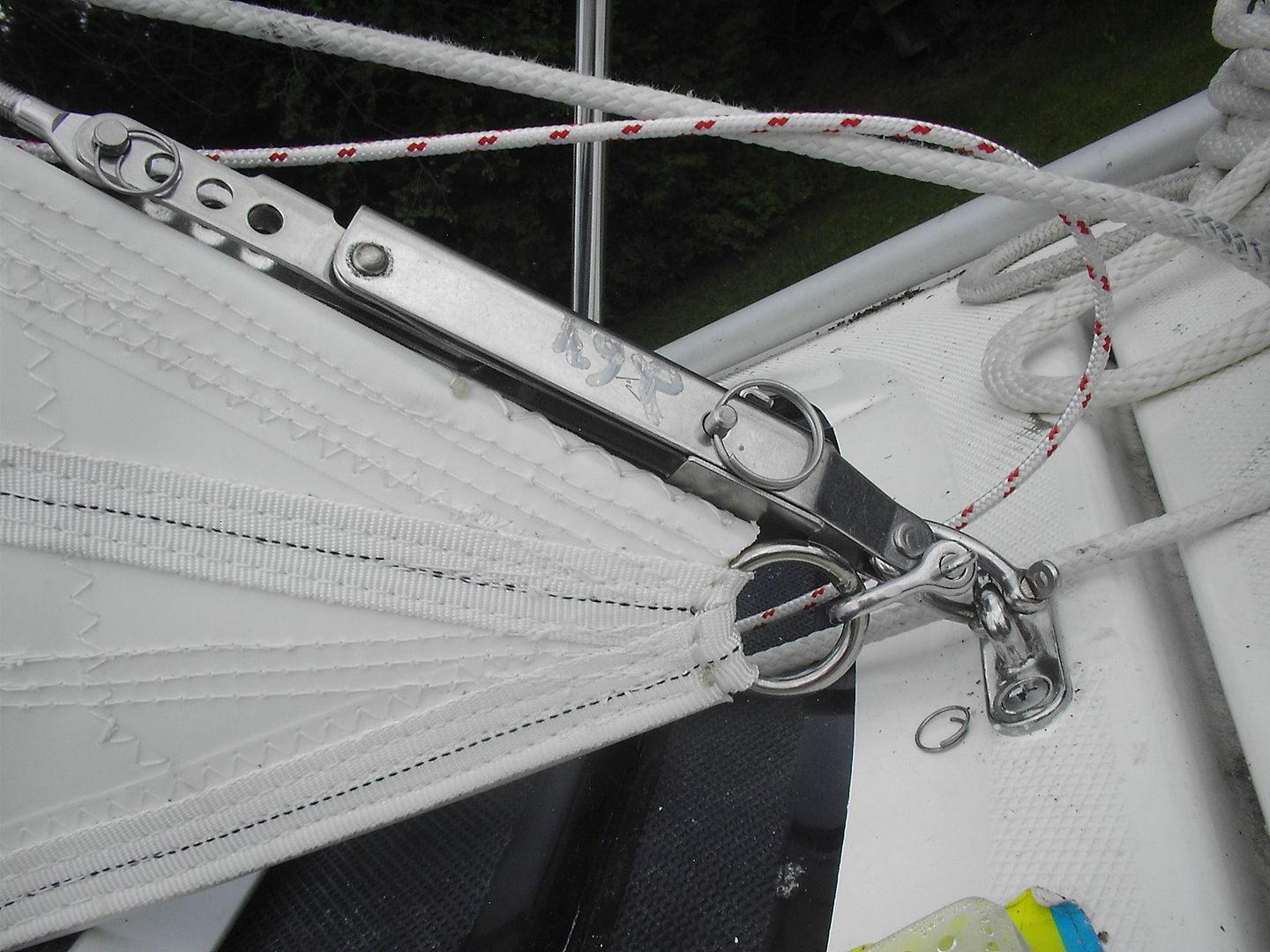

Hello fellows! Just jumping in this subject. I just finish doing this mod in my :macm: . I did raised the upper shroud braket exactly 7 1/2 ". Installed 2 turnbuckles in the shrouds mounts down at the hull and adjusted to exactly 7 1/2 ". Then installed one of this Hifields levers in my furler making it a sweet job to hook it up. Minor adjustment on all 3 turnbuckles (one inside furler to get the right tenssion). I does raise my genoa up so when fully unrolled will no scrape the stanchion rail tubes in the front. I hope this helps anyone in the future. I will answer any questions. Good Luck!

Can I ask what brand and model of lever did you use? Also, did you put turnbuckles on all 4 shrouds? And chance of some images? Thanks.

Hello again! The levers brand I honestly don't know. It has a little sailboat logo in it. The previous post from West Marine shows 2 models. I used the larger one with the 3 holes in one end. I did not buy it from West Marine however. Much cheaper that, shopped around. Again that was back in 2012 when I saw an :macx: with it but I forgot about the :macm: rotating mast and it was back to the drawing board. Then I figure it out by using the hole I have previously drilled and move the whole upper shroud/Genoa bracket up. The lower shrouds remain untouched since they are in a different bracket all together. No need to extend that. The turnbuckles I used come from Marine Parts depot.com. Best prices on SS hardware. They are rated for like 1200 lbs or so. Might be over kill but they were cheap. I just oversized the original 1/4 " hole to a 5/16". Will post pics tonight! Everything is lowered down right now but you'll get the idea, I hope this help.
