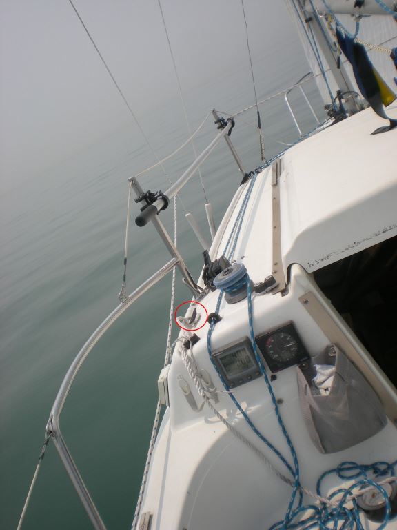

I often go in single-handed, but if there's another person (not watching the kids) then it's even easier. Often, the wind is from the south, blowing me away from my slip. :|
I found very quickly that having a cleat (PO, bless his heart) amidships (see image) with a line makes it very easy with a boat hook to "snag" the post mostly accross from it. I then use the winch to secure it temporarily while I secure the forward, aft and spring lines. If you are not doing it this way, then you are wrong, pure "d" wrong (as Bill C puts it in "I started out as a child"). :) It's also handy for making sure the entrance and exit is as easy as possible for boarders. When not in use, I leave it loose.

I do not understand - it's not your post but my ignorance - people have told me about 'breast line' but I don't think I have ever actually seen one, is this a breast line? I have often thought about trying a breast line on 'boat' but never tried it. Do any of you use a breast line? Is that what I am missing? Is that what that secret cleat is for on the dlandersson boat?

A brest-line is a line going from the bow or stern at a 90 deg angle to the dock, bow line go forward at more or less 45 deg from the bow, and the forward spring go from the bow aft towards the dock.
Aft they are called aft spring, aft brest and stern-line.
The brest hold the boat in to the dock, the spring prevent fore and aft movement along the dock, and the stern and bow-line do a combination of the spring and brest-lines
because of its angle.
When I single-hand, I first prepare the fenders, disconnect the lifeline in the cockpit-area and I place a line on the aft cleat,taking care to lay it on the seat with the bitter end where it is easy to find when I need it. Another line is taken from the bow cleat, and run outside of the rail and shrouds to the winch. I wrap it one turn and lock it on the cam-cleat. It is now really easy to take off no knots to undo at the same time it is not going to drop in the water either
Now I can come up to the dock, set the motor in neutral, grab one line in each hand and jump ashore where I tie the aft first, and then I go forward to tie the bow-line. after this I adjust as needed and then install the two spring and brest-lines.
Actually I don't use brest-lines, but they can be very useful sometimes in windy conditions.
The idea of using a midship brest is something I will have to try as it seem even easier than my own method :)
