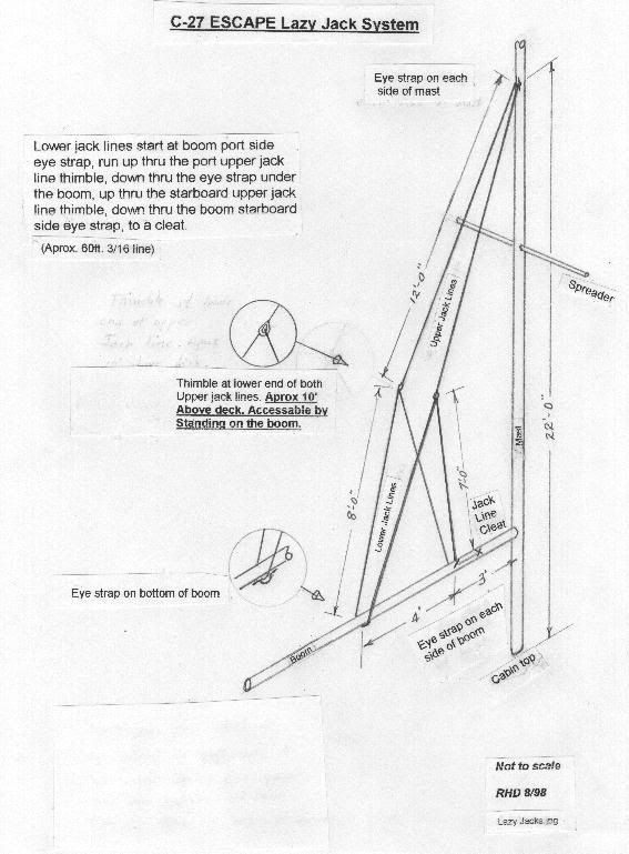

MACS are cruisers, not racers.
boltropes are for racers.
Change to sasil slugs and add LAZYJACKS...
Make life easier...
Search Internet Explorer under LAZYJACKS...THERE'S A HEAP OF INFO.
the top of mine are not fixed to the mast but pass through pulleys fixed to the spreaders aboyt 6 inches out from the mast, and the line continues back down to the small mast cleats for adjustment. The drawing shows a fixed syustem that seems not to allow adjustment for boom height.
