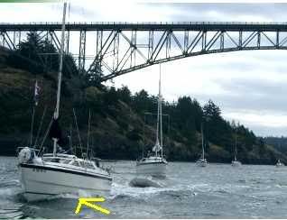

The reason the bow isn't in the water is because of the hybrid hull design. There is always going to be part of the boat in the water. When the boat is planing on the rear part of its hull, it is designed to lift the displacement type bow out of the water. The definition of planing is that the boat is now skimming near the top of the water versus pushing/plowing through the water at displacement hull speeds. When it is plowing through the water, the displacement of water causes a wave which comes off of the bow. The photo I used before for this is here:
You should be able to see the bow wave coming off the bow and rising up on the hull where the arrow is. There is no such wave in the picture above of the Mac19. As you transition from displacement mode to planing mode (about 7-11mph in a 26X), the bow wave moves further back until you have passed it. This is the hump that you see in your wake. Now the only thing you see coming off of the bow of the boat anymore is the spray deflected from the chines, not a displacement wave.
When you are doing 12-13 mph, that hump is very close to the stern of the boat, as you are on a very slow plane..just barely planing. As you speed up to 15-16 mph, the hump moves away from the boat and starts flattening out. The boat comes out of the water further and rides further back on the hull too as your planing speed increases. If you have a really big motor that gets up to 30mph, then there is a lot less of the boat in the water than at a 16mph plane.

Dimitri,
Thanks for the Pic of Wildest Dream on the 2003 San Juan trip, going out under the Deception Pass Bridge. Thats BK behind me...and...the photo credit goes to Frank M!

I can confirm that all those Macs in the picture of Steve's boat were not in anyway shape or form planing. I was at the head of that line of boats as the leader they were silly enough to follow out through Deception Pass into the San Juans. We were going just a tad under 10 knots as we all crossed Rosario Strait.
