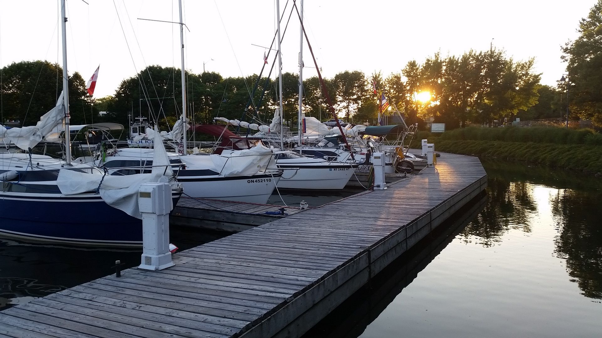

Remember that the shore power cord is on a 30A GFCI breaker in the pedestal, or should be if it's wired per the NEC, unlike the service conductors in your house (from the pole), which have no such protection (depending on system, usually on the primary side of the transformer which serves 3 or 4 residences, and the max current the x-former can deliver when saturated). But the incoming mains conductors should still be as short as possible before the first disconnect on the boat.
As to putting it under the helm seat, that's an attractive place for the inlet, but in my case at least, my shore power cord won't reach the pedestal when docked bow-in, even on the side of the finger, and I never back in. The connection with threaded weather collar is rain proof, as is the inlet with cover. A little dielectric grease keeps potential corrosion at bay. They're designed as rain/splash proof connections, and while not industrial connections, they seem to stay dry inside (mine does, at least, connected 24/7).

Tomfoolery wrote:As to putting it under the helm seat, that's an attractive place for the inlet, but in my case at least, my shore power cord won't reach the pedestal when docked bow-in, even on the side of the finger, and I never back in.
Most sailboats never back in. So why are most power connections someplace aft on the boat?

But even though it's 50 ft, my cord wouldn't reach if the inlet was in the stern. The pedestal is on the other side of the dock. Just sayin'. :wink:

Highlander wrote: Most sailboats never back in. So why are most power connections someplace aft on the boat?
Here I am backed into my slip @ one MMOR event the forth Mac from the front
And all I heard from the guy,s was that I was buckin the trend & screwing up a photo opp. :)
J 8)[/quote]
It depends how friendly you are - the friendly people have their cockpit and cabin door pointed towards the dock so people feel welcome to come visit and it makes boarding easier for guests - the unfriendly people put the cockpit and cabin door away from the dock for privacy so it's hard to board the boat and so people will not bother them.
