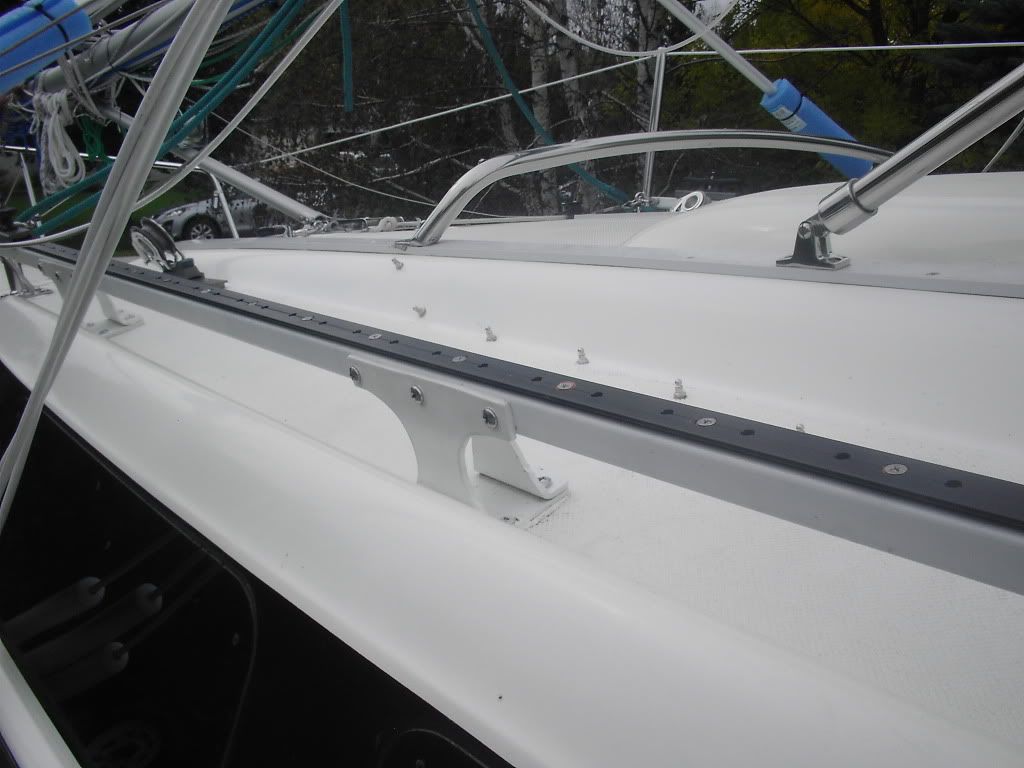

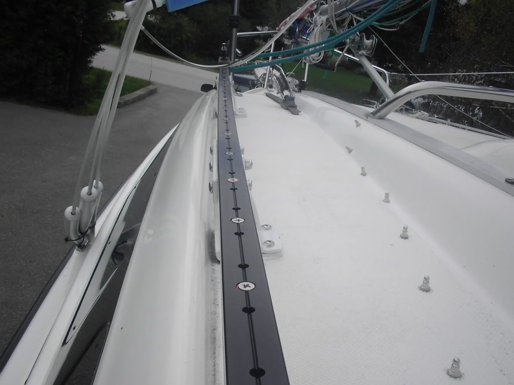

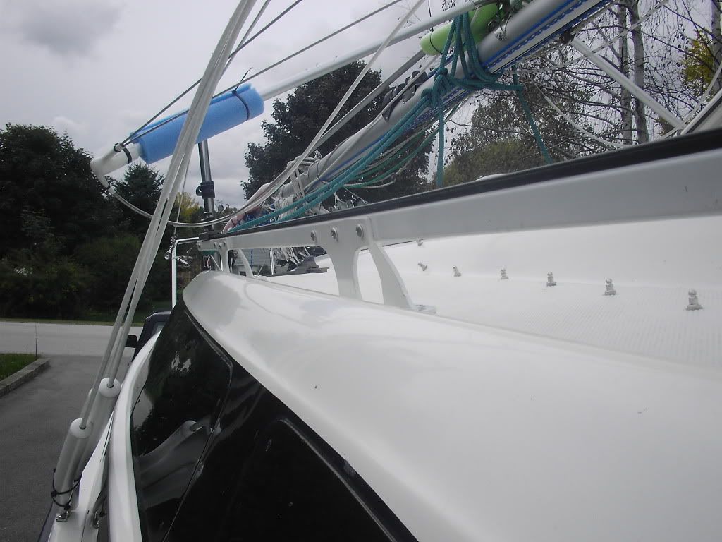

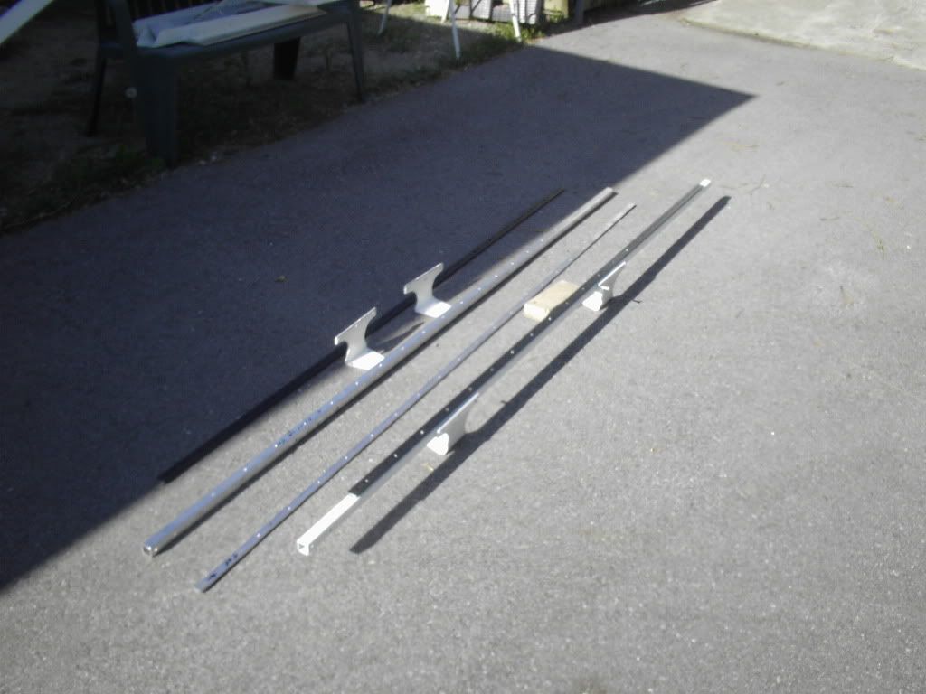

FYI: Not taking credit for the larger jib idea. Billy (XX) and I discussed this many time over that last years. We think that if this worked it would make the boat a lot more usable for making sailing distance in all situations.
Victor
Re: Replacement Sails
Hey Victor, it sounds like you've done your research but thought I would pass along a note a saw on the BWY website....
"130% or 135% Genoas simply do not work well on any of these boats because the mast shrouds are attached all the way out at the hull. The wide shroud base makes it impossible to properly sheet these in between sized sails for proper upwind sailing. On all Macgregor and Venture models (as well as a lot of other boats) these sails really don't do anything well. They must be sheeted outside the mast shrouds so they aren't easy to tack, but unlike the 150% Genoa, these sails do not extend far enough past the shrouds to wrap around them, so they are VERY limited in their ability to sail close to the wind. With a 150% Genoa, the shrouds fall into the "pocket" of the sail so you can pull the sail in much closer. While you will get a little more power reaching and downwind than a 100% Jib, it's not enough to make up for the disadvantages."
Perhaps you've got something figured out? I'm pretty new to this sailing Gig but I'm assuming that when you reef a 150 Genny you have to relocate the sheets to the forward sheet rail (same place as they would be for a jib), and this is where you are getting the "Wet Diaper" Sail?
This is very easy too remedy I have done it
First if u want to go with a 130-135 jib make a small but strong retractable or folding & removable bowsprit I,m guessing anywhere from 24-30" long I have designed & made several diff ones for the mac,s
http://i235.photobucket.com/albums/ee20 ... 010006.jpg
http://i844.photobucket.com/albums/ab1/ ... 52ab25.jpg
the banana bowsprit is removable & very easy to make urself
http://www.forespar.com/products/sail-b ... prit.shtml
installing jib track on the cabin roof is not that difficult a little time consuming thats all I,ve done it
http://i844.photobucket.com/albums/ab1/ ... 010012.jpg
http://i844.photobucket.com/albums/ab1/ ... 010011.jpg
http://i844.photobucket.com/albums/ab1/ ... 010009.jpg
http://i844.photobucket.com/albums/ab1/ ... 010008.jpg
http://i844.photobucket.com/albums/ab1/ ... 010007.jpg
http://i844.photobucket.com/albums/ab1/ ... 010018.jpg
These r 7 ft genny tracks I believe I,d have to check but mod will solve ur problem & bring ur sheets inside the shrouds
Hope this gives u guy,s some idea,s

A quick reply, because I don't have time for a long one:
You usually can't sheet a 135% inside the shrouds on any boat. The leech would hit the lower diagonal shroud. In general, for a rig with swept spreaders, the biggest sail that will sheet inside the shrouds is approx 105%. On a rig with swept spreaders, the biggest jib that will sheet inside the shrouds would be approx 105%.
Many, many boats have 135% genoas. It's the most popular sail for cruisers. I sell more 130-135% genoas than any other size. Every 135% genoa Iv'e ever sold has sheeted outside the shrouds.... and 135's work just fine for upwind work. Sometimes better than 150% genoas.
The biggest obstacle to putting a 135-ish sail on the Mac26X is that there aren't any tracks or jib leads in a the right place. I repeat: The shrouds and chainplate locations aren't the big problem. The lack of of tracks is the big problem.
You could conceivably solve the problem with barber haulers. or perhaps with clever track placement. Victor is working on that and Highlander has done some amazing things with his boat, so maybe he has some ideas.
Cheers. gotta go. It's a "work night. " I have to keep the paying customers happy. I'll drop in again as soon as things are a little less hectic at work..... oh, by the way, I'm heading off soon for 10 days of singlehanded cruising in the San Juans... by myself but in the company of friends.... and I can't go unless I get my work done!!!
