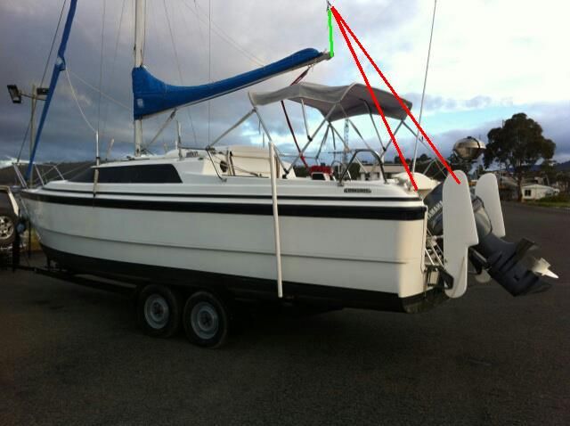

Hi Rich, youre absolutely right...sorry for the wrong terminology...so what I'm missing is the split backstay hence my confusion...have already asked the previous owner for this and if not avail, then will need to make my own...Hamin' X wrote:The backstay is there. It goes down to a pigtail that is used in place of a boom topping lift, then it continues into a split backstay. Part of the confusion was that Tom was calling the topping lift an outhaul.

Thanks again all for the very valuable input...so I'm going to fix the backstay issue by installing the missing split backstay, as to furler headsail/forestay, should this be connecting directly to the mast or is it ok to connect to the line (which then feeds to back of cockpit through inmast track)?

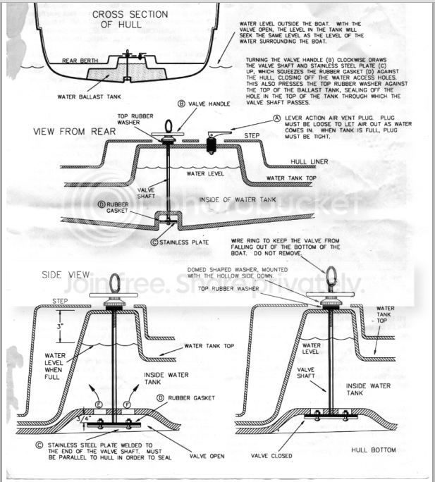

I've one more question, re the water ballast system...in the manual it states that I should be operating the valve next to the air vent valve to allow water in, however I was told to use the valve located at the rear of the yacht to flood the ballast tank...is that the proper way of flooding the tank or do I need to do both?

Open both otherwise it's like trying to fill a pop bottle you just get "glug glug glug"…until you put a hole in the other end then you've release the pressure and the water can rush in. Just make sure to close both when you're done filling.I've one more question, re the water ballast system...in the manual it states that I should be operating the valve next to the air vent valve to allow water in, however I was told to use the valve located at the rear of the yacht to flood the ballast tank...is that the proper way of flooding the tank or do I need to do both?

Will do...so open the air vent (stbd side of the step), the water fill plug (next to it) and the rear valve (back of transom) to fill and then close the three once filled?yukonbob wrote: Open both otherwise it's like trying to fill a pop bottle you just get "glug glug glug"…until you put a hole in the other end then you've release the pressure and the water can rush in. Just make sure to close both when you're done filling.

The backstay terminates on a tang on the starboard stern, per the pic below. I've never seen a split backstay on an
, but yours may have been customized differently. If it's split, there's another tang on the port side.

By saying to open both, Bob is referring to the gate valve at the transom and the vent under your step. I would not mess with the other valve, as it has been reported to be troublesome. The threads can become corroded and the sealing plate can become warped, preventing a good seal. Some owners have completely sealed the opening from below. There are several threads that discuss this subject. Here is a page from your manual describing the setup:tom wrote:Will do...so open the air vent (stbd side of the step), the water fill plug (next to it) and the rear valve (back of transom) to fill and then close the three once filled?yukonbob wrote: Open both otherwise it's like trying to fill a pop bottle you just get "glug glug glug"…until you put a hole in the other end then you've release the pressure and the water can rush in. Just make sure to close both when you're done filling.

Water fill plug? I'm not familiar with the X "fill" plug inside the cabin, but the picture Rich posted above indicates the X had another valve. I agree, I wouldn't mess with that one. The transom gate valve works well.tom wrote: so open the air vent (stbd side of the step), the water fill plug (next to it) and the rear valve (back of transom) to fill and then close the three once filled?
There should be an air vent (to prevent the glug glug glug) in the cabin and a big gate valve on the transom that is just below the water line.
To fill the ballast, open the large gate valve and remove the air plug to vent the tank. Once full, close them all to keep water from sloshing out.
Draining the tank can be done under power (with calm seas and fast speed) by opening the gate valve and the vent to allow the water to escape. Close them before slowing the boat.
Your mast is not OEM, but looks to be a nice mast with internal halyards. Without a backstay, the whole mast rig has nothing to keep it from falling forward except maybe the weight of the boom and main sheet. You need to correct this ASAP.
The photo below shows that you are missing the split backstay (red lines). Again, not standard OEM backstay, but in my opinion a better backstay than the stock one that is off center. The previous owner had it rigged this way once, so he must have these cables.
The green line is what I think you are calling the outhaul. You are describing an outhaul correctly. It attaches to the sail and pulls it towards the end of the boom. However, it should attach to the boom, not the backstay. You need both, an outhaul that is fixed to the boom, and a topping lift that holds the boom up when the sail is down. Easy fix.

Found the backstay (which is a split system) and its connection points both sides of transom.
Russ, you're absolutely correct as to the rig setup (backstay, forestay and jib), its all clear now...the backstay is as you describe, the forestay has the furler on it plus the jib halyard connects to top drum...it was tight when I tried to unfurl the headsail so will need to investigate this further...I understand now that the tension for the forestay/furler is adjusted through the shrouds...
The mistake with the backstay is that the outhaul is connected to backstay and I could not find the bottom bits...now all clear and I will reconfigure it as described.
I presume that instead of simply connecting to the backstay, I would need to run a new topping lift all the way (from boom, to top of mast and down to cockpit)?

After studying your photos, the only thing wrong was the missing backstay and you have that almost resolved. Great news!
That mast actually looks to be a very nice one with some nifty features like internal haylards and well crimped rigging.
You could run a topping lift up and back down. Some folks have. Mine is much simpler.
Here you can see my topping lift. The black/white line that comes from the top of the mast with 2 clips. In the photo, the lower clip is attached allowing the boom to drop down. The upper clip (below the flag) attaches when the sail is down to get the boom high above our heads. Simple.
