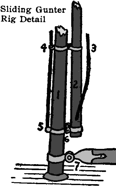

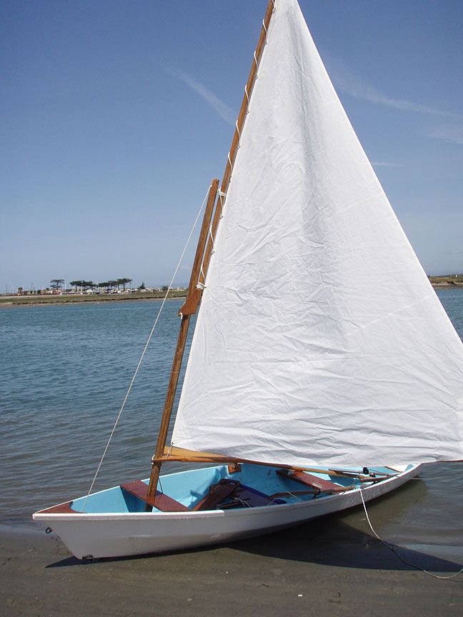

what would work for you would be the sliding gunter marconi/ bermudan rig,
mast remains stepped, release the halyard- drop the sail and the top portion of the mast-( gunter spar) it will slide down the main mast, leave head sails deployed- slip under the bridge - rehoist the gunter rig and sail simultaneously- carry on!!
only issue might be that you might want to head up to drop the sliding gunter, - and to raise it again.or at least luff the main, so that the sliding collar does not bind.
this does not effect the head stays or side stays- mast stays up- its just 10' or so shorter, and the full 30' length is attained by raising the sail and the sliding gunter
sliding gunter
folding gunter
come to think of it the folding gunter might be a bunch better for this application,
no need to head up,
just release the halyard,- that is lead back to the cockpit, and if the spar is stuck, tug on the leach,pulling the top of the spar away from the mast, and let the whole caboodle down and strap to the boom.- done
easy to reef- and might still be able to retain the spreaders.
if the folding gunter has a reciever on the now shortened mast head ( a U shaped thingie) to fit into- that will eliminate the gunter wanting to twist, and the bottom eye/collar needs to be oval shaped , and at (+ - 30 degrees) so when the halyard is loosened the collar is essentially larger, and when it is cinched up- in the raised position, the collar get tighter- keeping it in position on the mast.
maybe i need to sketch some pics!!!

That Gunter rig looks about as aerodynamic as a brick.
It will also be madness to reef or deal with in strong winds..
I notice a huge difference with the rotating mast.
Judy's sail, with the loose foot and the out haul adjusted right is great. Anything less I think will result in performance loss. I can sail right over my local flats with no board at all. I don't think I could do that without the rotating mast. It has more forward drive then a fixed mast. I had a single reef in 20k winds and the boat was great with just the main. I'd leave the mast down to go under a bunch of bridges before I took a big compromise on sailing ability.

hence the idea with the folding or sliding gunter.
1.the mast would still rotate
2.yes it will lose some aerodynamics due to the gunter spar
3. but an acceptable trade off for me!
huge amt of convenience for a slight drop in speed- maybe- but with the new cutter rig- the boat would be gaining some performance again :)

An aerodynamically shaped carbon fiber sliding gunter sleeved inside the mainsail luff and riding on two Harkin double battcars would work very well. It'll rotate along with the mast directly, and being itself aerodynamic, it will actually reduce wind drag because it can be much smaller than the mast profile. a 1.5" carbon spar would be more than sufficient to keep the top of sail up.
Chopping the mast at the top hound and using the integrated sliding gunter above that would take about 6' off the mast length which would be compensated by the sliding gunter.
Easily done with batt-cars. This would be a good way to go back to a bermudan style rig after the mast has been chopped for a gaff rig.
