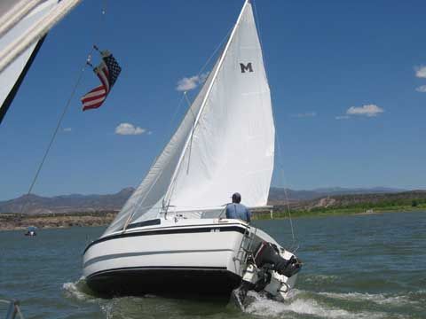

The way we fixed that on the A23 was to put a triangle on the backstay so it connected at the transom in two places - port and starboard - and those two connected into one backstay right about 3 feet above the boom, and then the single stay to the top of the mast from there. It also provided a nice place to hang a snippit of wire for a topping lift without the need to run a topping lift (that part was real nice).
That seemed to calm down the mast sway on the A23 pretty good, not completely, but pretty good.
'boat' trims up much better than the old A23 and uses a lot less helm - I was REALLY surprised by that - it was not something I expected ESPECIALLY since the rudder on the A23 was far superior and under the boat, not behind it like the M rudders. 'boat' seems to hold fine in light winds too - but I must admit I need to relax the sails to keep the same helm at wind speed 2 knots than i do at wind speed 6 knots.
I suspect that is because my apparent wind has shifted more to aft as my speed has decreased. If the wind only drops to 2 knots for a few seconds and it's not enough to make my forward motion slow dramatically the helm will continue ahead without input pretty good. If the wind dies for more than 20 seconds or so I must relax the sails otherwise 'boat' will start to drift downwind and i will be required to adjust the helm to point the boat to windward slightly. . . usually I wait, and wait, and wait and just before I'm about to touch the helm the wind picks up and 'boat' snaps back towards the wind because of the action of the hull tilting and slightly turning us upwind. (rounding). Here in the Pacific it's pretty steady after 11 AM so I don't have much of that after lunch.
If you fly by the front of the boat (stern out of the water like in the picture) it should turn all by itself to adjust for the wind without any need for helm input. A sailboat is also part submarine - that's what makes them so seaworthy.
