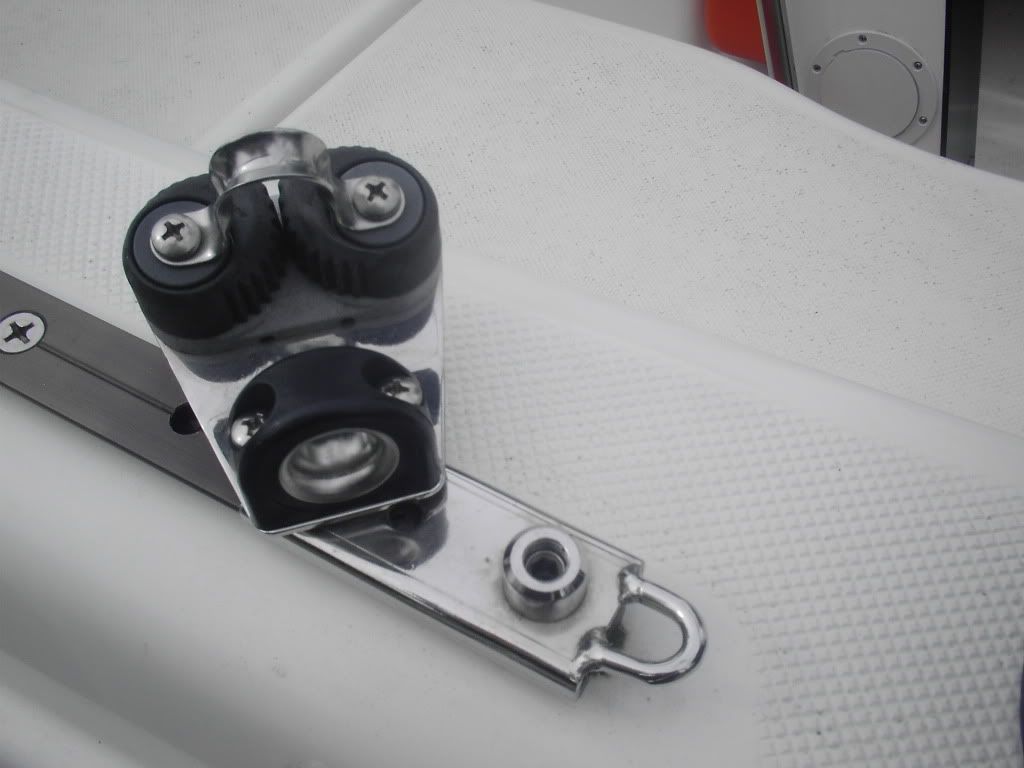

seahouse wrote:Hmmm. In the pix it looks like you need to use a (Phillips) screw driver each time you want to reposition the cleat. But can that be? They need to be easily movable for sail tuning, and for easy boarding. The forces experienced by this unit from the sheets at the rails would be less than with the factory sheave configuration (by about half, actually, not considering shear, and angle), so it needn’t be any stronger than it.
I believe I’ve seen these with a sprung pin (like the factory unit) that facilitates rapid position changes, but it looks tight in there for space, and it would make for a more vertical profile.
Part of the reason I have not been more aggressive in buying is because I like to see exactly what it is first. I might have ended up disappointed had I purchased and ended up with these? Or not. Please someone tell me I am all wet about this. Bill? Anyone? Maybe, in practice, it's not necessary to reposition it much, so this is a good compromise?
Thanks for posting the pictures taime1. Worth 1000 words.

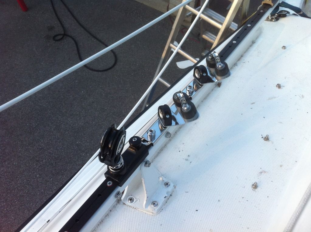

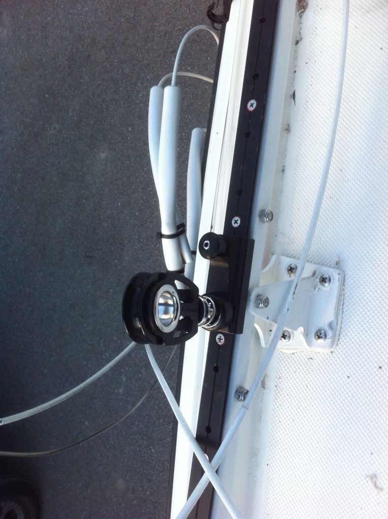

As I recall, the factory-supplied, upright spring mounted genoa cars are absent on your boat.(?)
Yes Brian
I have 4 of these cars
http://i844.photobucket.com/albums/ab1/ ... 010007.jpg\
and also upgraded to thses cars too :P
http://i844.photobucket.com/albums/ab1/ ... 010009.jpg
http://i844.photobucket.com/albums/ab1/ ... G_0851.jpg
