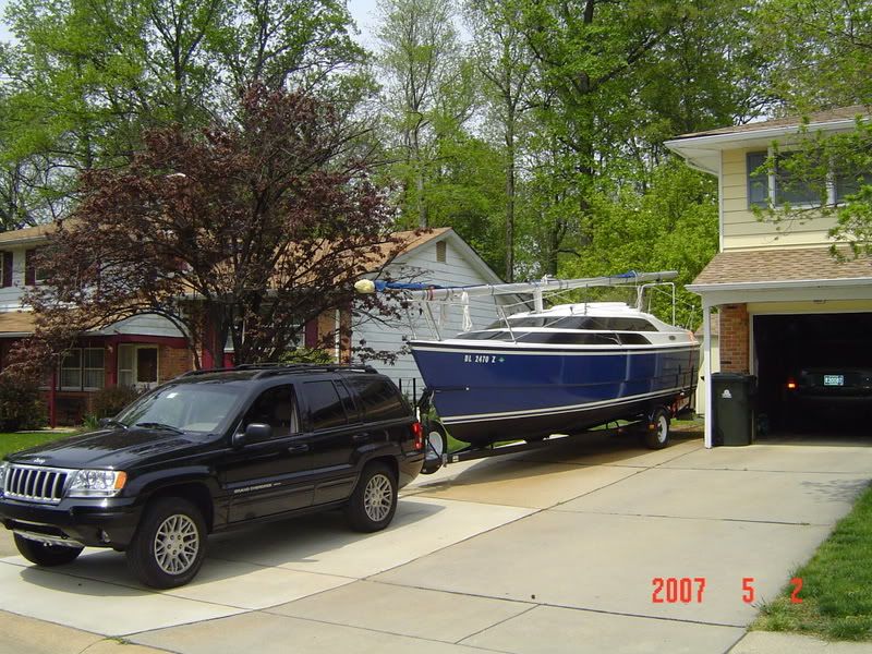

Here's Blue Heaven with the 3-point tie-down system that I use.
The short black bow tie-down is hard to see, but is essentially vertical. The orange straps from the rear cleats to the trailer are a pair of 8' ATV ratchet tie-downs. http://www.easternmarine.com/Motorcycle ... ack-05723/ These straps are the perfect length and include loops [described as "Soft Ties"] that easily wrap around the trailer frame. They don't cause any discoloration of the gel coat, nor wear on the rub strip. Since I have to tow ~ 40 miles to the marina in the spring over some uneven pavement, after applying $200/gallon bottom paint, I don't want any movement of the boat in relationship to the trailer bunks that will wear said paint off. The short ties are much less prone to stretching than a single over-the-boat strap, and better able to be "snugged" with their ratchets than would be true for a pair of dock lines.
