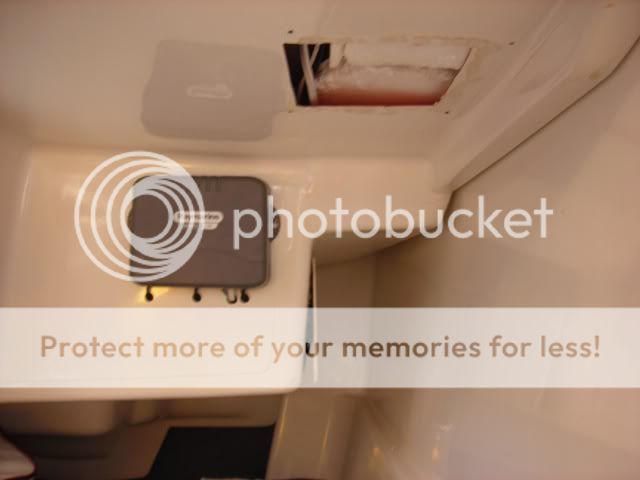

Where is the best place to mount the computer box on an :macx: ?
The manual is not really specific on this. Just a picture showing that in the center of the boat is good, and the bow is no good. But nothing about whether in the stern is acceptable. I would like to mount it on the starboard side in the stern above where the cardboard panel covers the transom.
Any thoughts?

I mounted mine at the top of the half-bulkhead over the port quarter-berth, because access was good for me and the wiring runs were better from there. It's close to the fuse-panel and the batteries, and Bossa Nova had a couple of access-plates in the headliner that I was able to remove for cable-runs. And even though I sleep in that quarter-berth, it's high enough not to be at all in the way.
The computer box on the X-5 is supposed to be mounted athwartships, so that it stays vertical while the boat is heeling. I don't know about the S-1, but it couldn't hurt to put its computer box in the same place.
