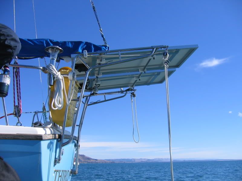

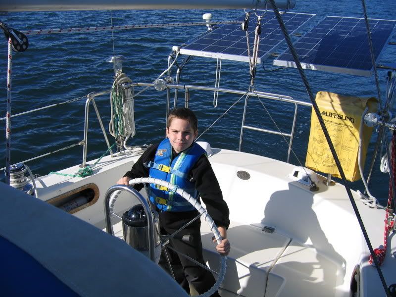

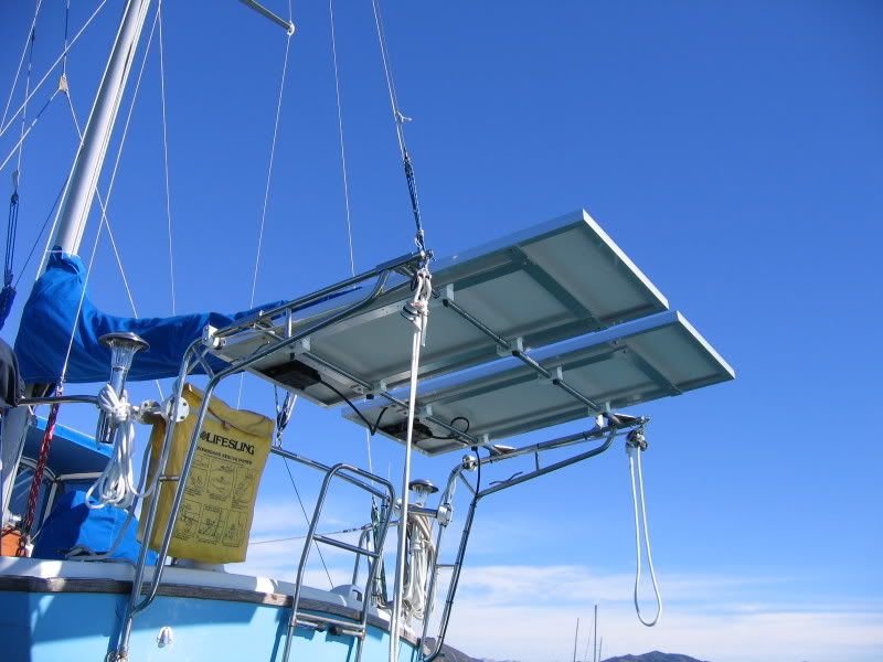

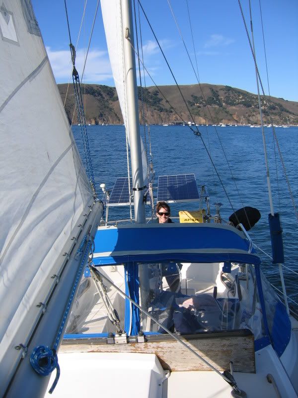

Update....the project is done:
I now have two Kryovera 130W panels and a BZ250 MPPT solar charge controler.
Purchased the DC3 system from here:
http://www.partsonsale.com/campers2.html
