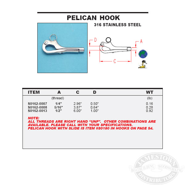

Re: Mast Raising Alterations 26M
Hi Jimmyt ,
These Pelican hooks I got on sale for $10.usa each from Jamestown
https://images.jamestowndistributors.co ... -58422.jpg
https://www.jamestowndistributors.com/u ... lican+Hook
1/4" thread you,ll also need the 1/4" threaded toggled jaws for the other end so as u can adjust them I already had some left over in my inventory from another standing rigging mod but they were not long enough so I just added the shackles that the pelican hooks snap onto

Thanks for the info on the Pelican hooks!
