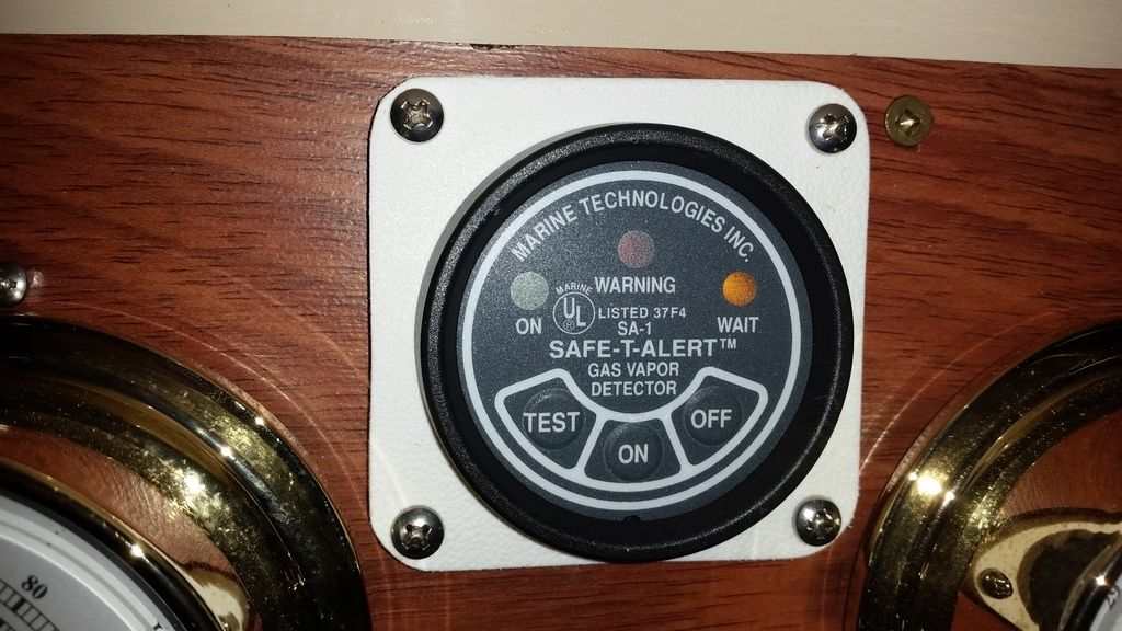

What I now need to do, is find a sniffer/alarm. That was Highlander's suggestion. Yo J, what did you use

What I now need to do, is find a sniffer/alarm. That was Highlander's suggestion. Yo J, what did you use![]()
- Posts: 5998
Re: Galley mod from the cup holder thread.
Ok Settle down here,s the one I used
http://i844.photobucket.com/albums/ab1/ ... m2xlyq.jpg
http://www.marineoutfitters.ca/index.cf ... 5456601113
There r other ones on the market but they r twice the price!
U happy now
U happy now
