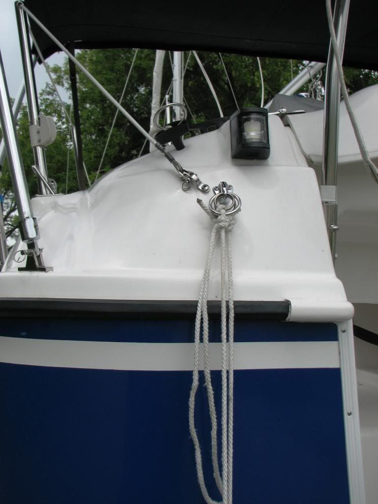

I'm not sure the clam cleat is a great idea for the up haul line - you probably want to cleat the rudders properly when they are up.
Something I discovered today as I was playing around with the steering - if you cleat the rudders up just by the D collars, you will find that as you steer from left to right slack will occur causing the rudder to fall somewhat. I have started looping the up haul line higher up on the the rudder to keep them fully upright throughout the steering range.
I think that, without doing this, the steering gets much more difficult because it's always pulling one rudder or the other up a little bit.

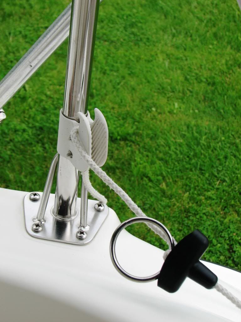

That's a great pic. Thankyou for taking the time to do that.DaveC426913 wrote:Finally got a good pic to show line layout.

Indeed. I always** cleat the slack on the standard cleat next to the clam cleat - because the lines can - and do - come out of the clam cleats.bobbob wrote:I'm not sure the clam cleat is a great idea for the up haul line - you probably want to cleat the rudders properly when they are up.
Just last week, I was sailing (or was I motoring?) and suddenly the wheel became virtually impoosible to turn. Looked back and saw one rudder floating in the water, sticking straight out. Not good for the brackets.
**almost always

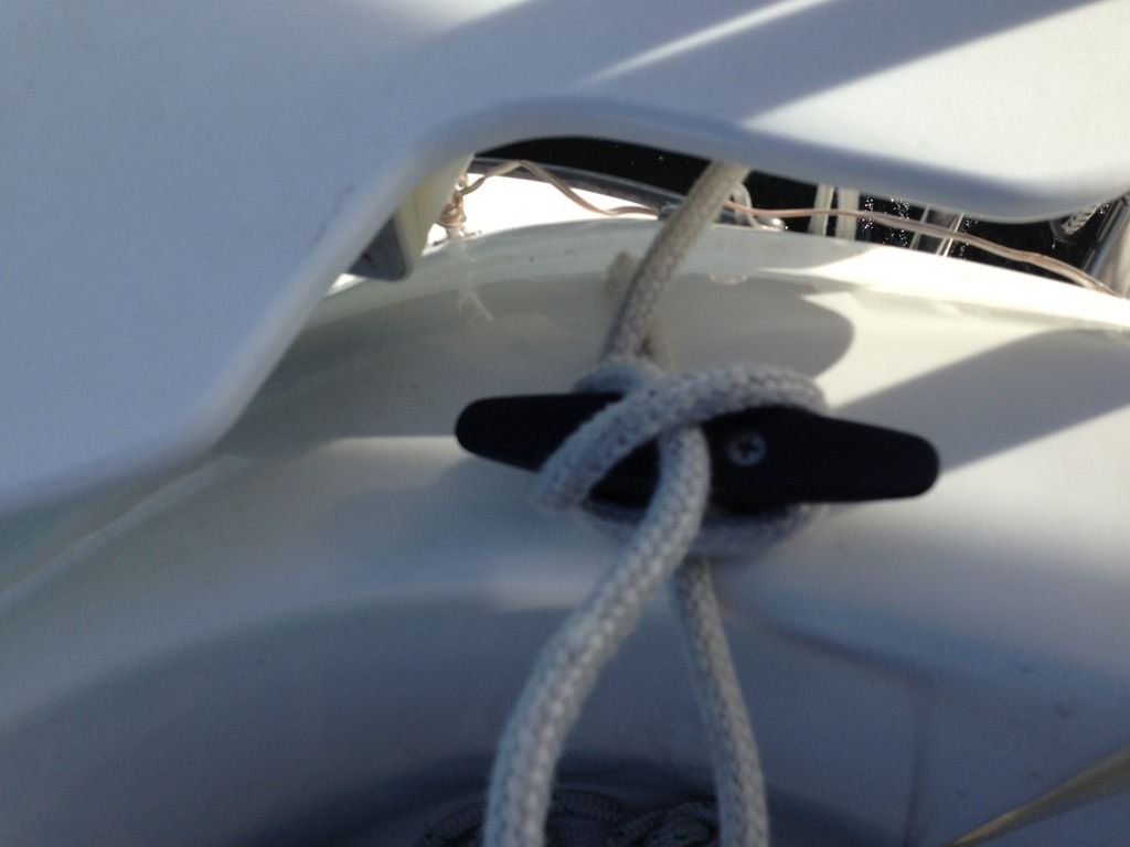

I don't have any fancy break away stuffs. I cleat the rudders with friction to keep them down, yet allow them to release if they hit something.
The rudder line holding it down comes through the cleat and I wrap the line around the cleat to create friction so it doesn't lift up.
(Line to rudder runs vertical in photo)
The wrap creates a "grip" so it doesn't lift up easily. A quick hitch holds the stuff in place. If I hit something, the line through the cleat gives way. SIMPLE.
I like simple.

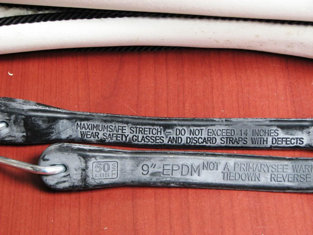

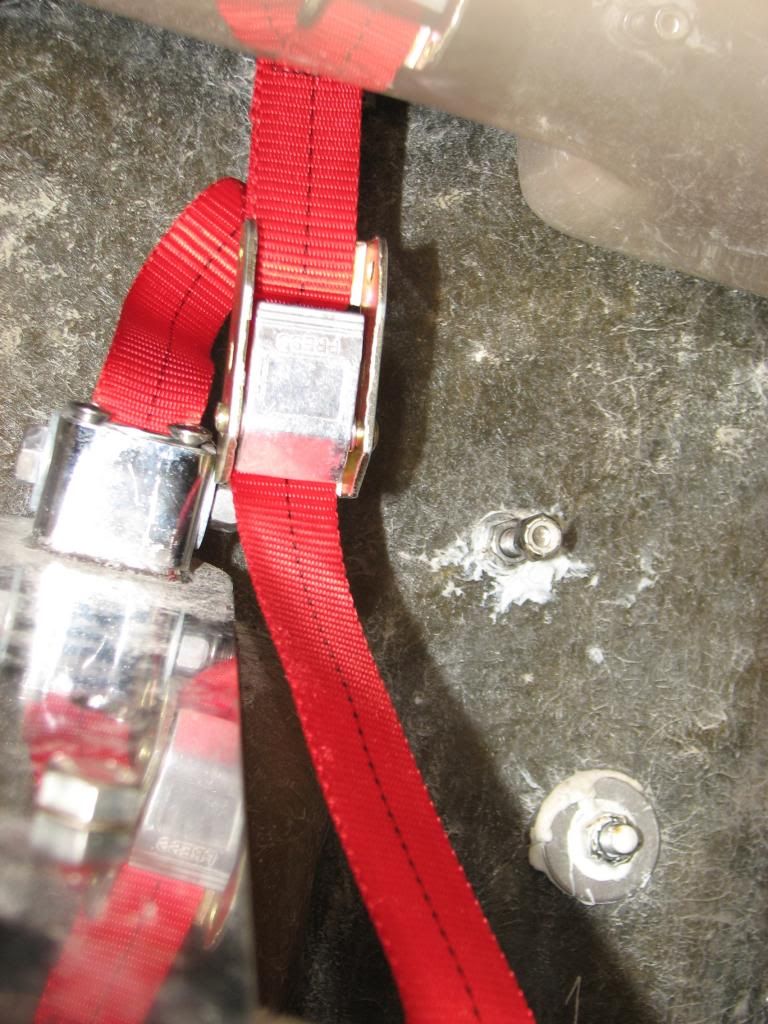

I replaced my rope with a heavy duty bungee system. Two per rudder for redundancy and it will deflect if it hits anything but stay down fully while sailing.
Here's the replacement downhaul (not hooked in).
Ross
Ross

Yeah, okay, now you got my attention.
I mean, really - the rudders never really see anything over 6 knots so there should not be a huge pile of force on the rudders when sailing? Does that make sense - I'm not much good at water hydraulics and stuff so I am assuming that the force on the rudder in normal sailing conditions is not going to be huge (?) so the bungee seems like a good solution for guys that sail in the shallows a lot (something I just don't do, but I can appreciate the problems you guys would face that are forced into such conditions).

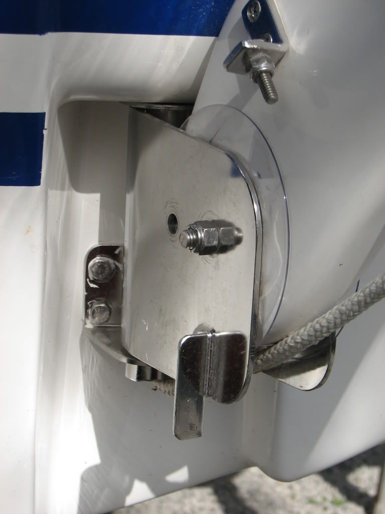

I think the bungee is a good idea except for one thing that is very important. Note, I have completely disassembled my entire rudder system and rebuilt it in the course of creating my auto pilot control because I needed precise geometry to create the system - so I observed a lot of interesting things about the rudder controllers:
The way our rudders work (on the M boat) is that they are supposed to be loose and floppy until they are cinched completely into the metal bracket. This prevents a rudder in the horizontal position from destroying fiberglass connections and races that the rudder pivot axle is attached to:
If your in a storm and the rudder comes loose and floats horizontally and you get knocked hard enough with that much leverage hanging out there it could rip the bolts holding the tang assembly right out of the fiberglass resulting in a hole below the water line - not a good thing - better to break a rudder or deform a tang than take on water. It's very traditional boat design from tiny sailboats to large cruise ships to make the rudder post soft enough to bend so it does not rip a hole in the bottom of the ship if it fouls. Bent rudder shafts are common, but not holes from rudders for this reason.
On the M
It's the part of the metal bracket closest to the boat that does all the work. The bracket could be bent out ward thus giving a loose rudder a lot of play but the part of the bracket that is closest to the boat - that WELDED part - is always going to have the same clearance and dimension no matter how bad the tangs are bent up - that's by design > in other words, by cinching up the rudder VERY TIGHT against that inner slot you are removing all the play in the rudder - EVEN IF THE TANGS ARE BENT - EVEN IF THE RUDDER BOLT IS LOOSE. That is why the solid - non stretchy rope is critical to removing all rudder play when underway.
Another thing I realized is that it's not really the rudder bolts that are holding the rudders against the water - it's THE ROPE! The rope is actually PULLING the rudder THROUGH the water. (Please forgive the emphasis words - I do this because my brain needs the talking points to organize my thoughts). Anyways - That rope is really doing more of the work than we might think - the rope is pulling the rudder through the water and at the same time it's keeping the rudder snugly in that "slot" that holds the sideways play in check. But think of the geometry when you turn the rudder - the rudder presents itself to the water in a sideways fashion - it's the ROPE that is actually holding the rudder against the boat and pulling the rudder through the water!
If the rope can stretch - it presents a possibility for the rudder to dislodge from it's snug slot - then the question is - does the connection have enough force to return the rudder to a secure position? If the connection IS strong enough to return the rudder snugly then is it also too strong to save a rudder from damage on a rock? These are the things I would wonder about.
Still I think Ross might have the best solution to working the shallows as long as you keep things on the slow side it seems like the best way to manage the rudders. I would not use such a thing in heavy seas myself.

BOAT, I'll reply to your lengthy post as well as I can but ask that we not go too far with this in order to avoid excessively hijacking this thread.

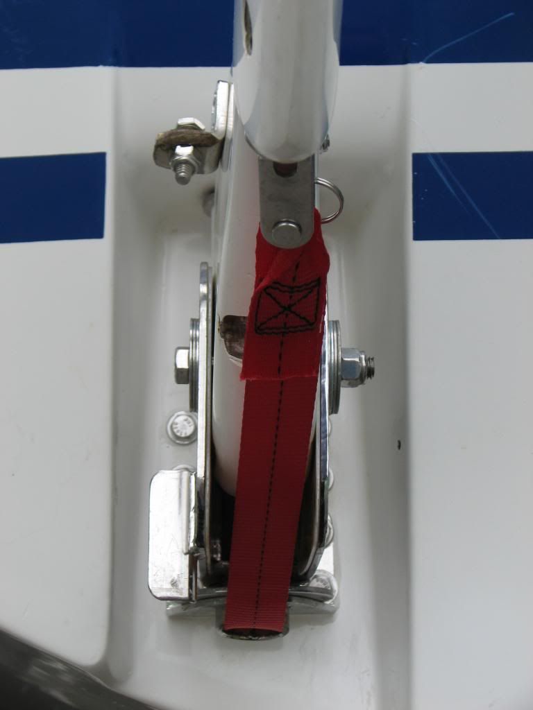

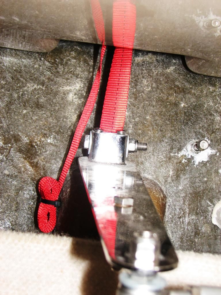

I have to apologize about my first picture as it was an earlier version and not representative of what I ended up with in the end. I finally ran with three 9'" bungees (shown below) to both provide more force when set down, and to allow the connection to the rudder attachment point to consist of a synthetic strap for easier sliding over the welded rod in the bottom of the rudder tube when the tension is put on. It also circumvented the exposure to the rubber of sunlight and water. I had to replace one of the earlier pairs due to cracking for these reasons.
Now the shorter, and more robust assembley(s) fit inside the tube leading up to the topsides with room to spare and can be set to eliminate any slack by simply tightening the strap cinch.
Here's a pic inside with the rudder deployed and the clamp up inside the tube.
http://i1121.photobucket.com/albums/l52 ... 13cbd2.jpg
I can also shorten or lengthen the line on the ring in order to fine tune things a bit more.
http://i1121.photobucket.com/albums/l52 ... 9d1770.jpg
Also notice that I've taken the stock position, and dropped everything lower by a bracket dimension. I did this with the wishful thought of obtaining a bit more 'bite' with less turning (drag) required while sailing. It's hard for me to conceive of anything being torn through the very thick transom - especially with the final inside washers I installed - and regardless my mod will be re-visited once more to add a second custom retaining bracket (inverted) containing a bearing, and possibly eliminating the spacer currently used. That will capture everything much more solidly.
http://i1121.photobucket.com/albums/l52 ... G_2239.jpg
http://i1121.photobucket.com/albums/l52 ... G_2351.jpg
http://i1121.photobucket.com/albums/l52 ... G_2487.jpg
Some of your theory concerning ropes and slots is a little hard to visualize but in fairness it's the eventual elimination (or minimization) of slack and play that we're all after, and anything that avoids a fail in the haul-down rope can only be a good thing in the end. We sail in interesting waters in this part of the world and regardless of shallow water operation, do encounter more than our fair share of deadheads, branches and shoals. I've done runs where we've touched both without incident or malfunction. Swells and waves get pretty interesting up here as well! When we are exceeding hull speed, either under power or running down-wave, you can observe the water pressure forcing the rudders off the stops slightly, then returning properly after the event. This is as intended and I don't have to worry about a stretched or failed ageing stock rope anymore. Roger made a good boat but everything is capable of improvement right?
Regards..... Ross

Different strokes for different folks I guess. I would definitely not consider that enough tension.RussMT wrote:I don't have any fancy break away stuffs. I cleat the rudders with friction to keep them down, yet allow them to release if they hit something.
I like simple.
Not only do I cleat my rudder lines off tightly, but I even "twang" on the rudder line (like it was a guitar string) to be sure there is both zero slack and no chance of give. I don't want my rudders lolling about even a few inches.
