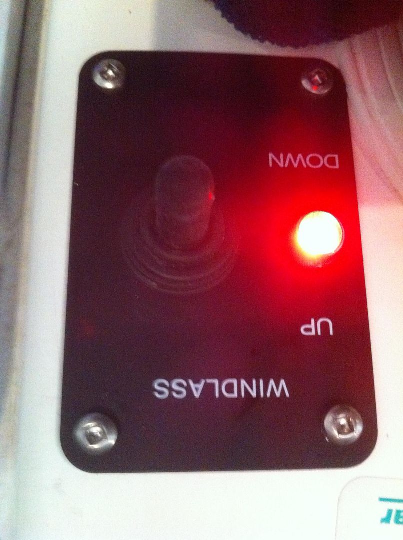

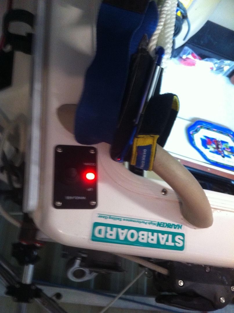

I,m pretty happy with my set-up anchor winch switch @ cockpit
http://i844.photobucket.com/albums/ab1/ ... 399c6e.jpg
http://i844.photobucket.com/albums/ab1/ ... 3c2e31.jpg
