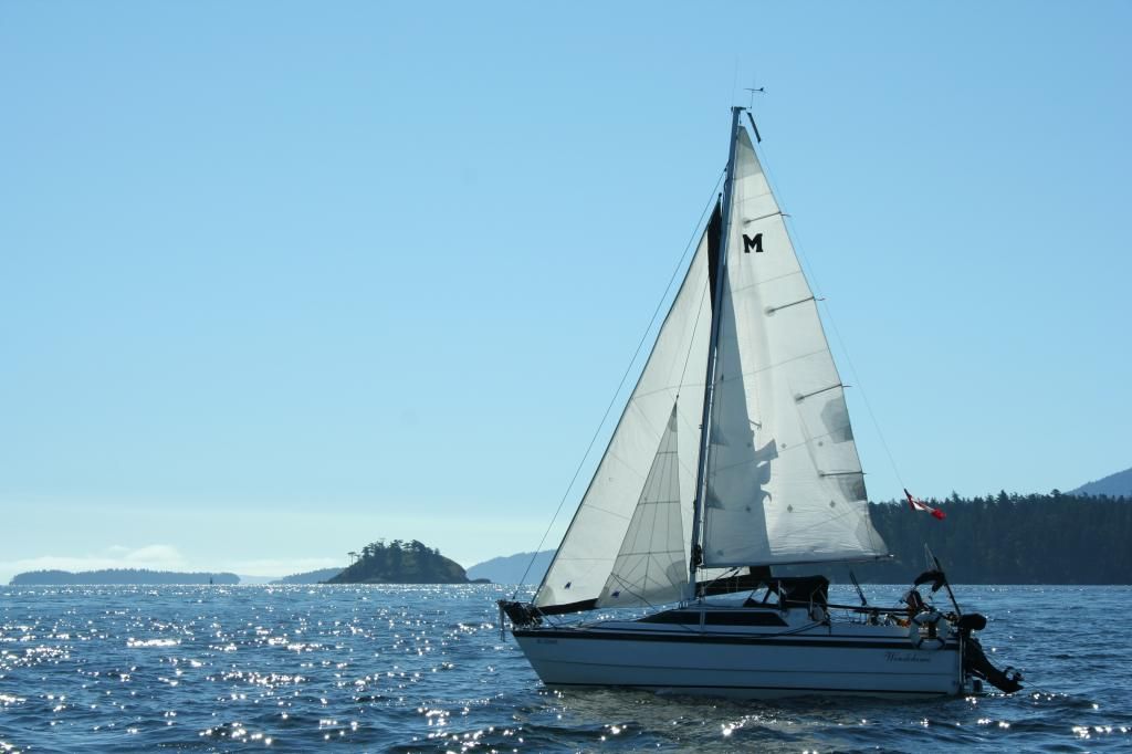

Looks like the second set of reef points are about the same distance from the first set as the first set is from the boom. Does that sound right?

Ya, that sounds about right although I've never actually measured the distance. I think the bottom picture might give the best view when you look at luff reef cringle and reinforcing triangles.

BTW, that sail looks nicely trimmed in the picture you posted
