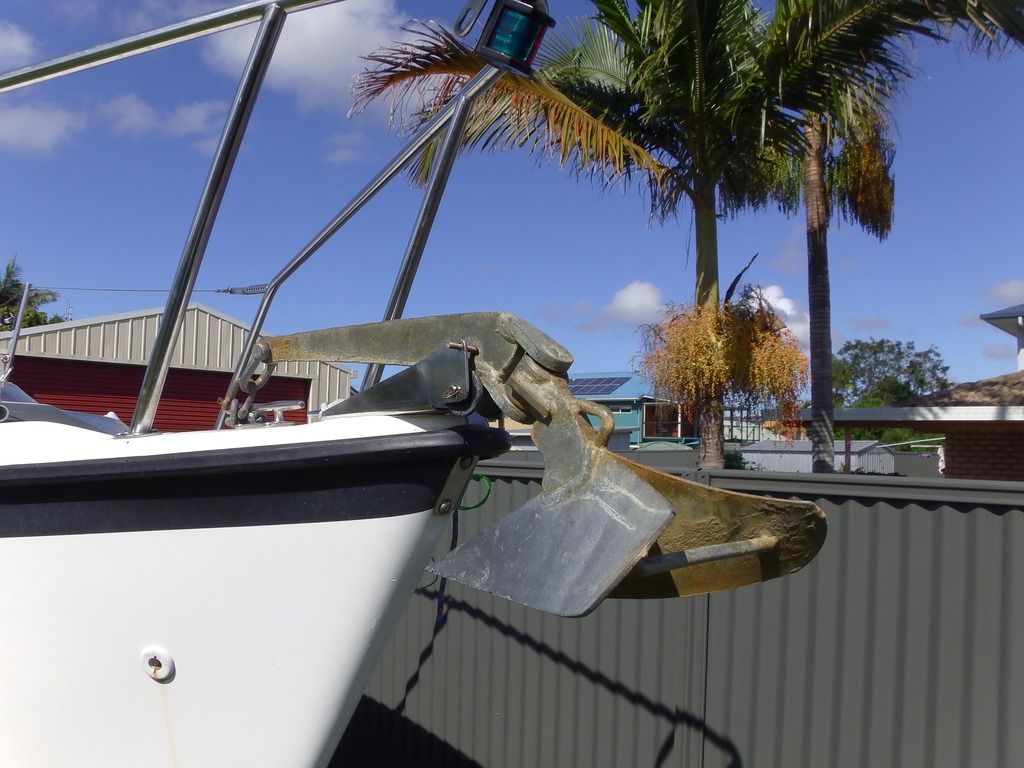

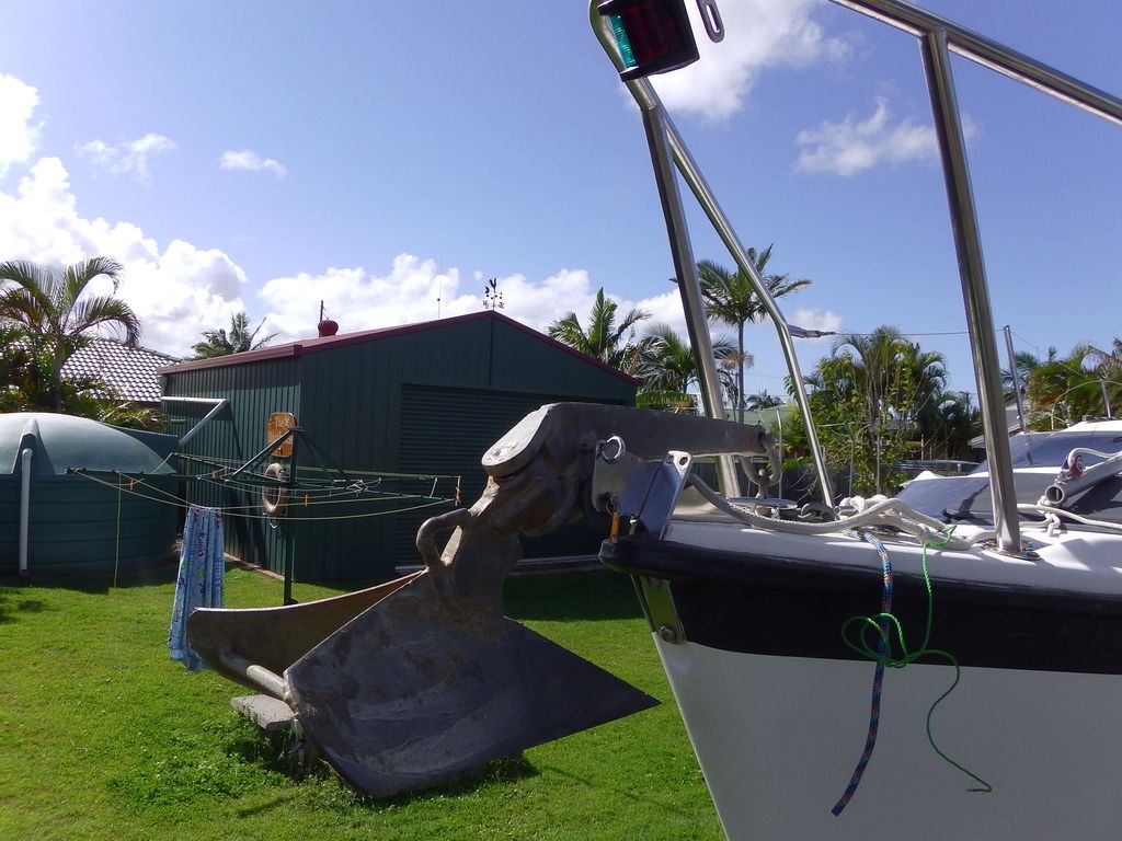

Perhaps its because I'm poor, or cheap, or maybe a bit simple, :o but,, I just drilled a hole in my anchor and stick an eye bolt through using the existing anchor roller. To start with I was putting the nut on the end but realized (after loosing the nut in the drink) that the pressure holds it just fine so don't bother now (it has the back up of having the chain locked into the cleat anyway). In a blow when the boat is swinging like mad on the hook, I put this eyebolt through these holes in the roller and put a nut on as it stops the stock roller sides from bending apart. This was meant to be a temporany thing until I bought a decent roller, but it has been this way for years :)
Just my opinion, and based on my experiences, but, the anchor locker on the Mac does not fit an anchor big enough for this boat. I had several instances of dragging with the big sand anchor I had and it was well dug in and on a scope of more than 10 to 1. The last instance was a sandy/muddy bottom - I came up out of the cabin to find us about to be swept onto an oyster lease. Just got the motor going and moved us in time. That was my last straw and when I decided to upgrade anchors.
Have had a 27 pound plough now for years and recently upped to 18 metres of chain, and mostly this has worked fine - although recently the boat still dragged in a blow. I drove down to check on it as it was blowing hard and sure enough it had moved a couple hundred yards and was almost onto another boat. I raced home and got my kayak and got out there quick smart (at midnight this was).
