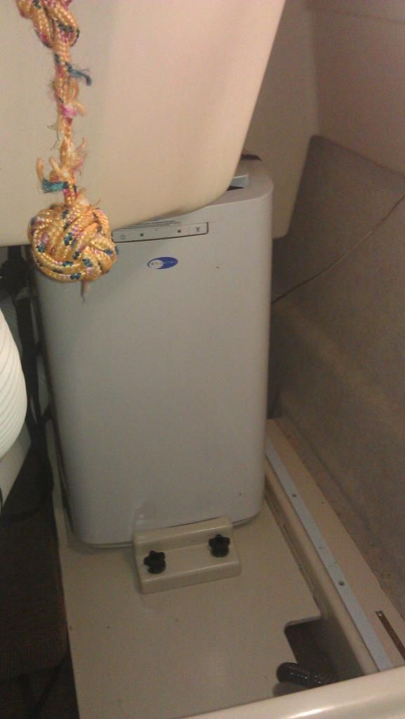

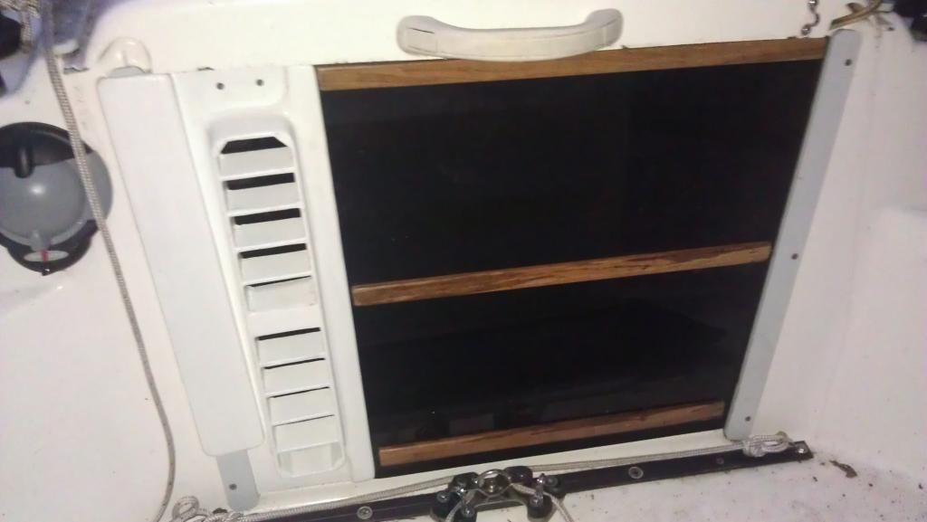

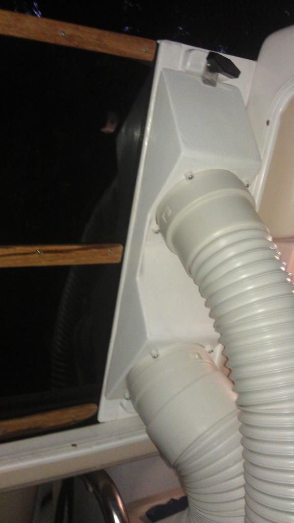

Here are a few pictures of my free standing dual hose AC install.
This is the louver unit for the two hoses (intake and exhaust) that leaves the majority of the companionway open
Here is the AC unit behind the galley - the space is never used. I made a platform above the cushions to tie it down to.
The louver unit grabs onto the port side companionway hatch guide. I made a second pair of Plexiglas companionway boards to fit.
Can easily enter and exit the boat - just not sure how well it will cool down the boat though. Bought the two hose unit to keep the cooling cycle isolated from the cabin air.

My galley is fully aft.
I needed to use the extension hose set.
Mine is intended to power off AC shore power but I have experimented with a Honda EU2000 generator.
Our arrangement from port bow to stern is a Dometic electric cooler, about 6 foot of sofa, the galley fully aft, then the AC unit.

Yes, the EU2000 could start it - but there was not much to spare. Really only workable on shore power with the high load on the generator. And the noise!

Current model is the ARC-110WD, 11,000 BTU
