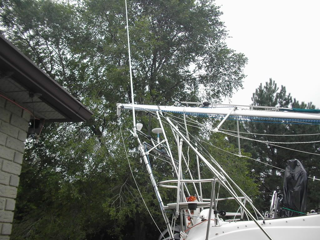

Re: Backstay Install?
Gez Guy,s lighten up the guy is just asking for advise & help not criticism ! :o
Now me I will give him some constructive criticism :arrow: :idea: :)
u want 4 furlers u gnna need a backstay :!: period :wink:
http://i844.photobucket.com/albums/ab1/ ... 56a38b.jpg
http://i844.photobucket.com/albums/ab1/ ... f1233a.jpg
If U want to fly a drifter or cruiser from the masthead on a furler U gonna need a backstay
http://i844.photobucket.com/albums/ab1/ ... ca9729.jpg
Now if he wants a backstay then so be it & with an inner or outer forestay for a cutter or sloop rig like me why not , remember I did add a 3rd set of masthead shrouds & a second set of spreaders
lets start with the masthead swivel brkt
I,ll have to find the mods then post the pics from photob
