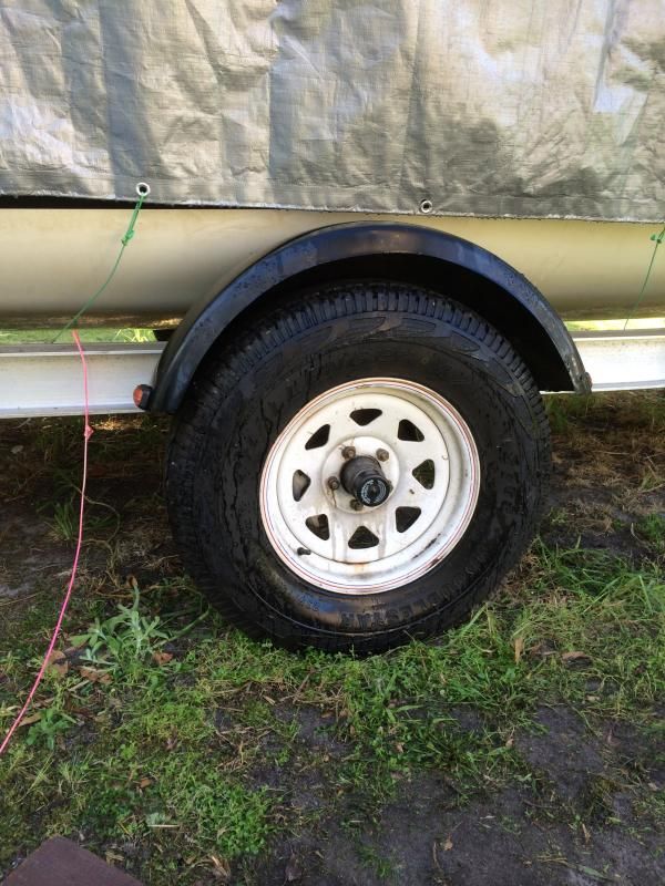

I gave up as we are leaving on Monday and I'm too busy. I wedged the guards up and took it for a test drive on Sunday, and found them still occasionally hitting the guards. So now I have wedged the guards hard up against the boat and ground off some of the glass inside the fender....
Looks like it should do the job for the trip. I'll check it after the first 50 miles and if its hitting, I'll just have to turn around and cancel the trip.... Thought about putting the old tyres back on but am a bit scared of them...
I'm not really sold on the idea of adjusting the suspension as the front of the trailer already angles down a bit and this would make that worse and mean I'd have to do something about that too.....
Not sure what other tyres Aussies are using where they arnt having this problem?

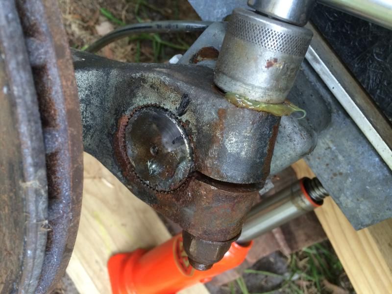

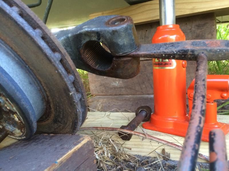

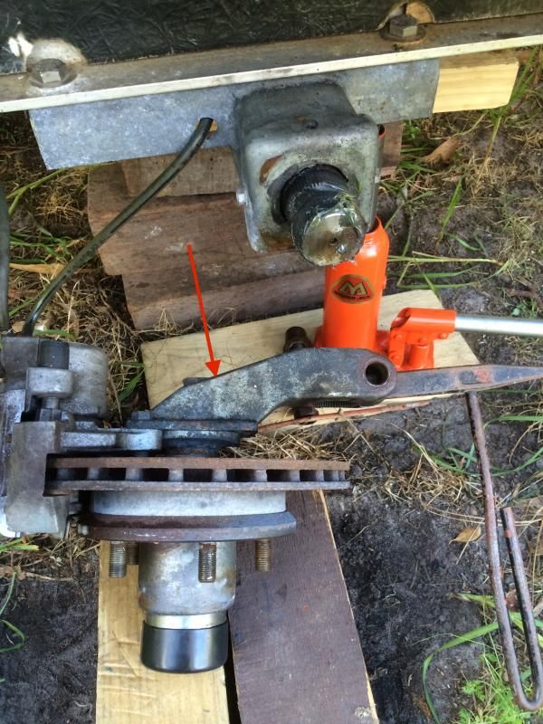

Success!!!

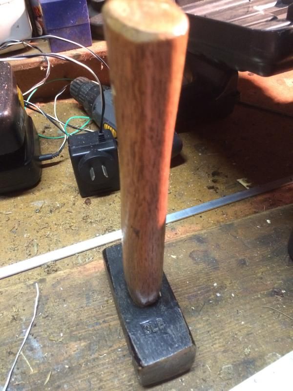

My 3lb gentle persuader
oh and a wider spreading tool
Using the gentle persuader where the arrow shows - gentle tapping metal on metal - the arm comes off.

The rotation I used can be seen from the marks - maybe 6 splines.
The end result is
The guards are still canted up - need to drop them again.
