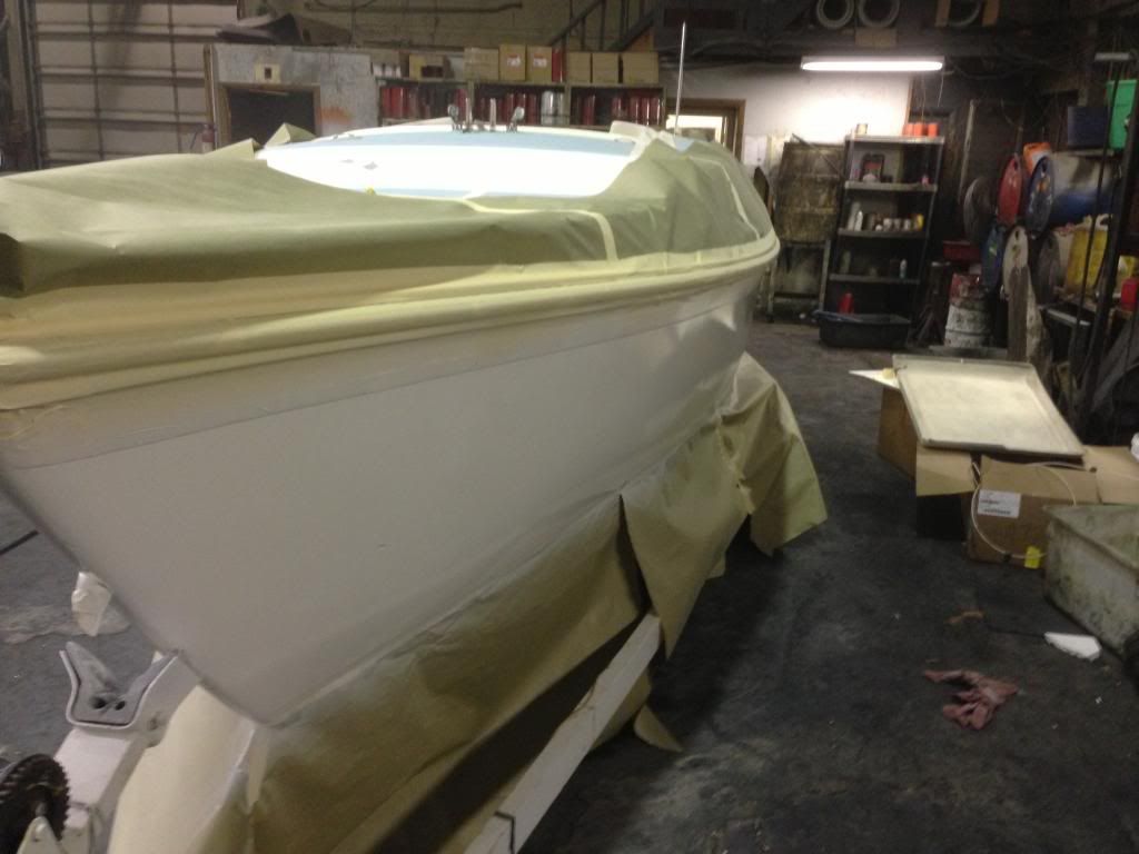

Well I got my boat ready for paint. Sanded everything and cleaned it all very well. I bought interlux bright side and am having a problem. I keep getting fisheye in some spots. I'm using a paint gun, and have never had it this bad before. Maybe a previous owner waxed it a lot? How far does wax penetrate? Any thoughts? I paint semi trucks, first time using marine paint. Is there something I should know about marine paint? The thinner I have is what's recommended on the can. Time to Re-sand and try again.

Did you use a wax remover before you sanded?

Did you wipe the boat of with the worst smelling solvent available?
Only time I have a problem with marine paint is if there's wax or oil. Silicon based Protectants are bad too. I painted my hull with interlux bright sides and no problems. It was rolled though.

No I did not use a wax remover, I have a feeling any wax or whatever was used might have penetrated deep. It was only in a few spots. I removed all the paint again and used a more course sandpaper. I do have good solvent and I did wipe it down. Took all day to re-prep it. I will paint again tomorrow. There is some anti fisheye additive I bought I will add to the paint. I put so many hours in its getting frustrating. If it fish eyes again, I don't know what to do. I'll get picks up soon

Be very liberal with the solvent. Your sanding before using it has spread and driven the wax into the gel coat and you may have difficulty getting it all off/out.
Awlgrip wrote:Removal of all surface contamination (waxes, mold release products, dirt, grease, oil and mildew) is imperative to ensure adhesion of the new Awlgrip Systems.
Note: Always clean the surface before sanding. Sanding the surface with sandpaper does not remove wax or other contamination. Sanding spreads the contamination from one area to another. Sanding often melts greases and oils into the surface making it impossible to obtain a clean surface.
Good luck. Perhaps other members have tricks that might help you.

Ah yes that is a very good point. I did my best so we will see what happens tomorrow :?

Ok the additive worked, paint looks great. Next week I will finish the rest of the boat hopefully.
