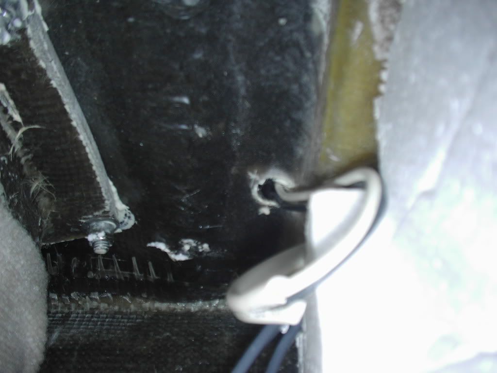

Thanks for all the info....right now I just want to add a cheek block to the top of the original daggerboard cheek.
:?: I am still not sure how to get to the thru deck bolts for that cheek block :?: .
I have a 2011 M, and the only thing that looks like it might be an access is the fake wood "ceiling" that surrounds the daggerboard housing and is over the forward dinnett seat. Lots of screws, and I am guessing lots of foam in that area. This is not one of the simple "mirror" type access ports. No problem for me to tear into that but, just want to make sure that is the right way.
As always any help is really appreciated. :macm:
c130king
Posts: 2730
Re: Halyards back to cockpit - 26M- Rotating Mast
Post by c130king »
Unscrew all those screws and then pull out all the foam blocks/planks. You can also remove the panel on the port side the DB.
Hopefully that will give you access where you want to install cheek blocks.
