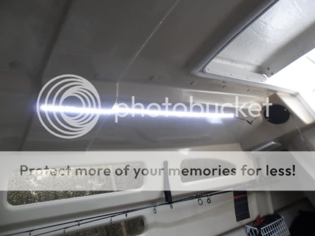

Paul,
We bought 2 of these in the cool white. They are the best we found for low current draw & brightness. 6 amps for 5mtrs. Can cut them up into 1m lengths and solder wires then switch - fuse & anderson plug. We velcro'd them onto cabin ceiling. Very f-ing bright :idea: compared to the diode leds.

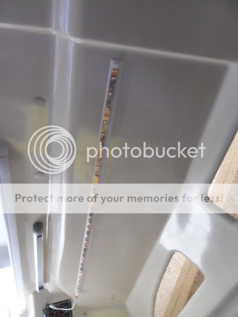

Pics hwi...
Wired with inline switch, fuse & anderson plug. Velcro allows for quick removal so I can use em elsewhere.
Links to andersons & stickyback velcro...

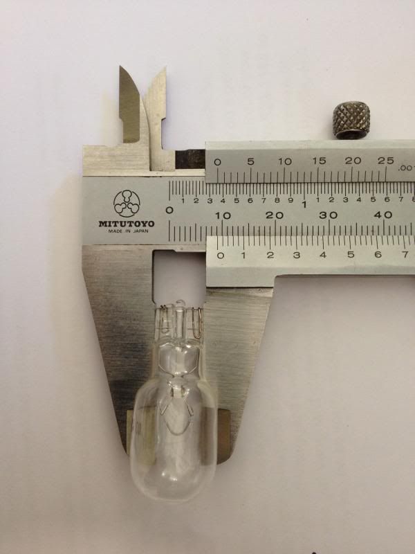

Dave, in your searching did you find a model number for equivalent globes to the stock mac globes? I have not taken my lights apart yet but they seem to be not the typical globe. Almost halogen in type? The links in this thread to the eBay store no longer link to the globes you mention.
Edit. G4 is the type. Nope. T10 or W16W - see later post

G4 is not the correct type for the cabin lights in my 2011 hull.
The correct type is T10 or W16W as follows
Having bought the G4 however I can say they will fit. You need a small strip of something that will not melt and bend the G4 legs over the strip to imitate the T10 above and then push the LED globe with the "hacked" connector into the mount. If the strip the legs are bent over is correct size, the globe will stay put.
