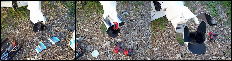

Ok so I got a thruster for a 10" and up prop which is as big as he lists but reading the literature it appears you can buy a bigger one (special order), any way put the thruster on the dinghy which has a 15hp honda 9 3/4" prop and had some scrap stainless and made one 15.5% bigger for the Mac.
:D 15.5 % because that was as big as I could get out of the scrap.
Tried them out today on the dinghy first with substitute load and the wife and thought it was going slower until I checked the plotter which said 32 kph but it makes the motor very quite and very good to steer so the wife jumped out and I got up to 42kph but it seemed like the nose was up like it wasn't planing properly even though going faster than ever 6-8 kph.
Took the Mac out without the thruster lightly loaded and it hit 15.7 knots and running at 5500 rpm on the big prop,
fitted the thruster and yep it made it quieter? but only revved to 5400 rpm and 14.5 knots trimmed it to full and the nose came down and it went to 16.9 knots and rpm stayed the same.
Trim has only ever made a very small difference without the thruster and it was still climbing when I ran out so maybe it could benefit with a shim? and this could explain the nose up attitude of the dinghy as I still had two holes to go but that was where it always planed best prior, unfortunately by the time I discovered the trim on the mac the dinghy was packed up and couldn't test it.
Filled the ballast and got 14.3 knots at about 5250 rpm on the Mac.
The most impressive effect was the quietness and the steering response, absolutely magificent even when coming into dock without the motor running had way more control.
All up am more than pleased and now looking forward to testing for economy which should be good as it was doing 5.3 knots a 2000 rpm and absolutely purring at all speeds.

Can you test it at different RPM ranges before and after too as I was just in plain too much of a hurry with light to do more than WOT but think you will find trim makes a huge difference and might pay to check this before and after too.
Looking forward to your results, I presume this is the standard size 2?
I had the cavitation plate pre drilled and only had to smear some Duralac and put some tape on, note would pay to have a battery drill to run through the tape and a knife to cut the edges.
