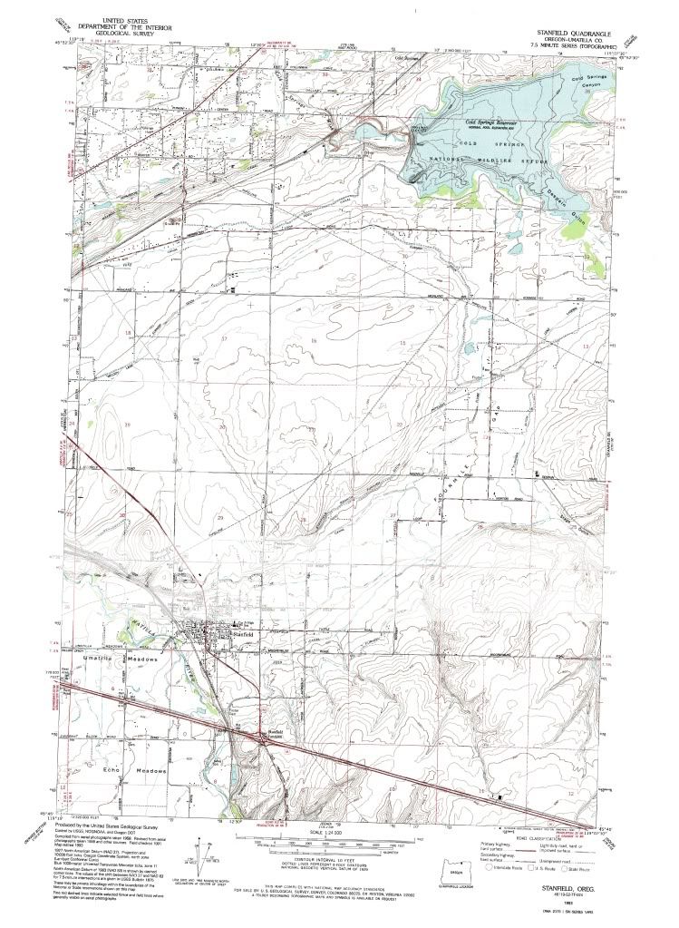

No need for special software, Adobe Reader has all you need.Sumner wrote:Have you tried to scan any maps and use those. You can download free USGS maps for the US in a PFD format.....
Free USGS Topo maps..
I've been trying to figure out how to get them from the PFD format to a format SeaClear can work with. I see conversion programs to go from PFD to say JPEG, but can't get further. I think there is a way and if so then I could create some inland lake maps to use with the SeaClear that might be shared. If I took the time to do one and someone else did another then we might end up with a database of inland lakes that you could navigate with SeaClear.
- 1. Download free USGS topo map for area that you want.
2. Open PDF and take snapshot of entire map using snapshot tool.
3. Saved file as BMP.
4. Move image file to the Seaclear\Charts directory where the KAP files are located.
5. Start MapCal and open image.
6. Set chart properties.
7. Convert to WCI
8. Set 4 calibration points. I used the NAD83 hash marks at the corners.
9. Set Border points.
10. Save calibration.
11. Scan for new charts. Message shows 1 new WCI chart found.

The map/chart above is Halls Crossing/Bull Frog on Lake Powell where the car ferry goes across and where we took out on our last trip and were we will put in on the next trip to try and finishing sailing the length of Lake Powell. I down loaded the free USGS map and followed your instructions. I hunted around once or twice to get going in the right direction, but the instructions were great. Thanks
The route (red line) would be leaving from the ramp and starting up the lake towards Hite at the end of the lake. I can probably get a map downloaded, and converted to SeaClear in probably less than 10 minutes a map with a little more practice.
The only thing I couldn't figure out how to do at first from your instructions was the part after step#2 "Open PDF and take snapshot of entire map using snapshot tool." I couldn't figure out how to do step #3 "Save file as BMP". I had to open a graphics program where I had a blank page up and then pasted the image into it and then use the program to save the file as a BMP file. I'd like to get around that and see if I ended up with a clearer image.
I was trying to make it too hard. Using your instructions opens up about any place in the US, since you can download the free USGS maps and outside the USif you can find a map to the area that has some Lat/Lon markings on it.

You may certainly feel free to re-post the directions and even expand upon them, Sum. They are about a freeware program that is in the public domain and I posted similar directions in the SeaClear II Yahoo groups, last year.
As far as step #3, you may need to clarify it according to your operating system. I use XP pro and when I use the snapshot tool, it is automatically saved to my clipboard as a BMP file, so I just have to paste it, using MS Office Picture Manager. Just for grins and giggles, I just tried it by pasting it into MS Paint. It was pasted as a BMP and I had the option of saving it as a JPEG, GIF, or others. Still, no special software needed. Happy to help, but YMMV.

Expanding on step #2, I find that you need to set the Adobe Reader zoom level to 200%, then start the snapshot tool in the lower right corner. Keep holding the left click button down, while moving the cursor to the upper left, just off the document and let it scroll to the upper left, while holding the button down. When you release the button, it may take a while for the program to acknowledge your copy, as it will be a very large file. For a good example of the detail that you will obtain, here is a link to one that I did of my local Quadrangle. Caution, it is 76 Mb:
http://i496.photobucket.com/albums/rr32 ... ldTopo.jpg
On Edit: It appears that PhotoBucket reduces the size, so the true detail does not show.

I had started going to 125% zoom and that seems to work well for me, but maybe I'll try higher. It is way better than the one I posted a while ago and can read the map in SeaClear to the highest zoom level. Another night and I might have the upper (last 50 miles) part of the lake mapped out. I'm using the 7.5 X 7.5 topos and feel they will work fine for me. It is also moving from one to the next. Good program and good instructions.Hamin' X wrote:Expanding on step #2, I find that you need to set the Adobe Reader zoom level to 200%, ............
This is pretty neat,
