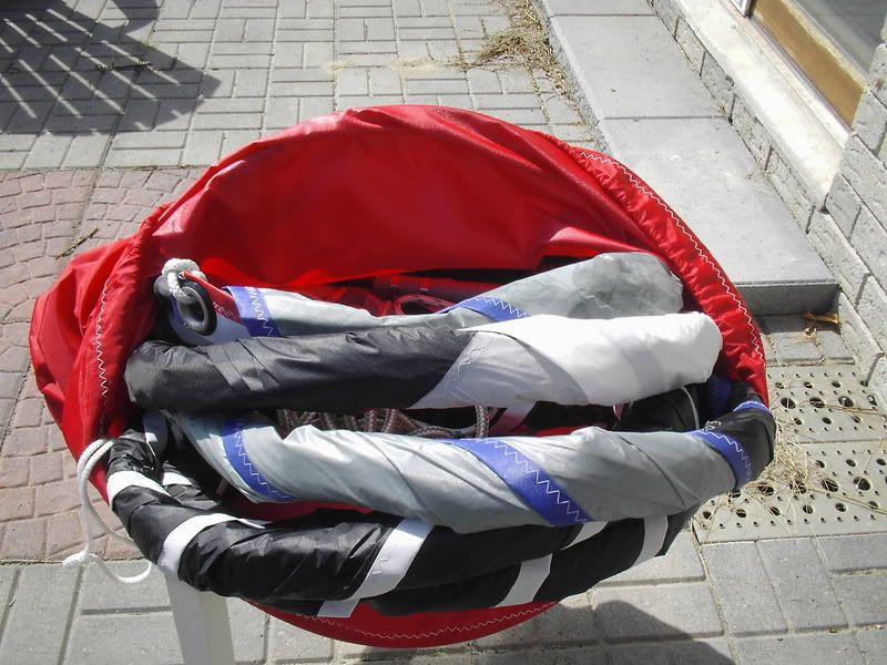

for about the same money you can buy a storm jib & a harken 435 furler have the sail modified to be fitted for 1/8" seized forestay , now you have a storm sail that can be used as a inner staysail on the furler so on windy days hoist up the storm sail on the harken furler which it stays attached to all the time and can be easily rolled up in a bag just like my drifter on a CDI spinnaker furler shown here
http://i78.photobucket.com/albums/j95/m ... 0002-1.jpg
so now go sailing if winds are light fly both jib & inner storm if it gets too windy furl the storm jib if it gets any rougher you can either reef the jib or furl it & unfurl the storm sail all from the comfort of the cockpit
I just had a quote from K/H for this mod to a storm sail i thought it would be the cheaper way to go , but as I already have a K/H storm sail "hank-on" I got a quote from my local sail loft to convert my storm sail for 100$ cheaper :) so once I bring the boat out of my shop & raise the mast to double check my measurements looks like this will be the way I will go
a cutter rigged clipper she'll be :) :wink: J
