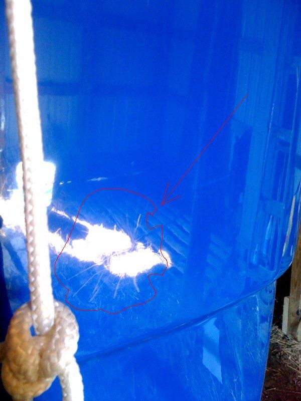

I found a heartbreaking anomaly on the aft in the blue gelcoat. I bought the boat in mid November and sailed her then. I went over the entire blue area of the hull when picking her up. This blemish wasn't there. I've been out to the boat and checked it over many times throughout winter and washed her on a warmer day in November and never saw this. It did get down to -8 degrees F with a lot of temp fluxuations.
Today, it was warm enough to finally apply her Registration and name decals. In the sun, a glaring area which looks like the boat was hit very hard with a baseball or something was very noticeable behind the starboard rudder. I couldn't see any cracking on the inside. There are no scuffs in the wax/gelcoat indicating something hit my boat in the barn. It's just that suddenly, there are very noticeable spider vein blemish in th blue gelcoat. Weird. Heartbreaking.
Sorry the picture doesn't show it well do to the reflection and glare of the sun. Has anyone seen this before?

This is moving away from 'blister', but I raised a similar issue as yours at
http://macgregorsailors.com/phpBB/viewt ... 44#p176944
Your photo does not seem accurate to what I have had....that white reflection is misleading.
I know blue looks absolutely brilliant.....but at times I wonder about its longlivity...especially when I am polishing one!!

The spider cracks in the photo looks like someone hit the dock hard. I have a similar scrape a just bit more forward on my port stern but it is not spider cracking. Happened when I was backing my
into a slip and got caught in a eddy and I overpowered to correct. Should of just let the current take me where it wanted and aborted the docking. As a wise old Captain once told me, " Always approach the dock at the speed at which you wish to hit it"
