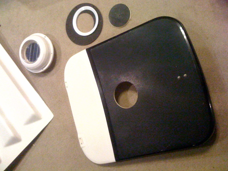

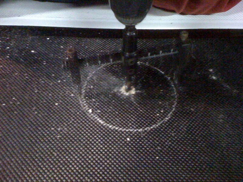

Yikes, drilling the first hole in your boat is a difficult thing to do...

Doug W wrote: Yikes, drilling the first hole in your boat is a difficult thing to do...
Yes i know, i hate it, and was walking arround the job like a kat arround hot milk,,,,

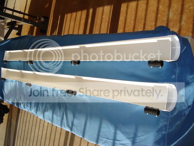

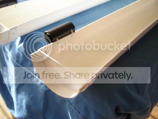

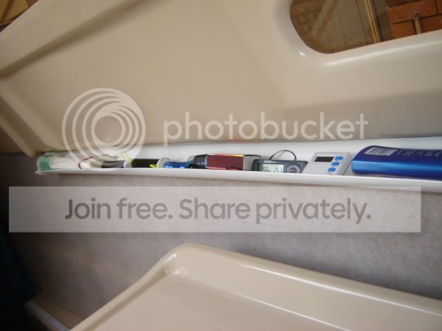

Shelving, no holes, fits under cabin liner...
90mm stormwater pvc piping - halved longways...
Short bits of 19mm poly pipe zippy tied on, compress & push under hull liner to lock in. Ends are 90mm ends cut in half.
Functional :wink:
Decor :|

Nice thinking, but if you heal the boat, u emty your shelevs
