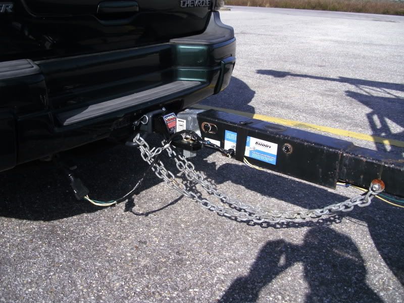

I have a "pin" that locks my "hitch latch" (terminology????) in place. I also stick a padlock through that same hole to "lock" my hitch when the trailer is sitting unattended.
Here is a pic of the tow beast and König on it's trailer at the Love's fuel stop in Foley, AL. The second pic is of my hitch set-up...you can just see the "lock pin" or at least the ring-ding on the end of the lock pin just forward of the black painted part of the trailer brake control. The electrical umbilical is sitting on the ring ding.

Nice tension on those chains Jim.... 8) 8)
ll have to retract my post on adjusting the latch - yours is completely different than mine. Ill post a picture of mine when I get a chance.

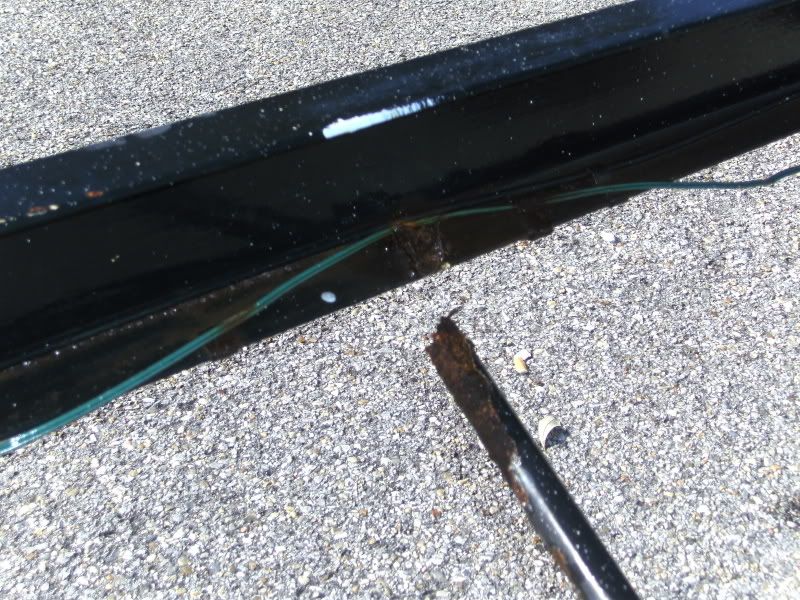

Rigged the boat all by myself...went very well. Launched solo...went...not so well. Actually the launch was okay but when I pulled the trailer out of the water here is what I saw

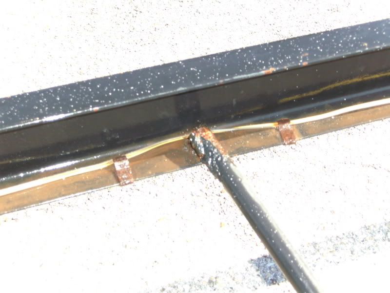

And this is the other side...also rusted but still connected.
This is the cross piece forward of the axle. Rusted out on the ends. Does anyone know exactly what the purpose of this piece is? My theory...the ramp was steep. I had the ballast valves open. I backed down until the tongue was just to the edge of the water. The aft end was just floating but the bow was still dry and sitting in the bunks. I had tied the docklines loosely and then unhooked the bow-eye from the trailer winch strap. Then I back down another couple of feet and the boat came off the trailer. Due to the steepness of the ramp I am thinking that maybe as it backed off the trailer and the stern rose, the bow may have dropped or slightly dug in and hit this cross piece breaking it.
Or maybe it was broke the whole way from Florida. I really don't know.
I will try to find a welding service and see if they can fab me a new cross piece and weld it on. Hopefully I can get it fixed in the next two weeks over the holidays...I have to be back in Jacksonville NLT 3 Jan. I see a new galvanized dual-axle trailer in my future if/when I move back to the U.S. in 6 months.
But I did get some sailing in today. It was a good day even with this issue.

it looks to me like it is a support brace,i find a local welding service and have the guy weld a new piece back on,then once the weld has cooled,paint primer on to the area of exposed steel and later once dried,paint the area.The area around the original weld spot may be weakened so i would have the welder add a plate over the area
I would also suggest,having the insides of the box sections checked,it may be corroding from the inside out
i dont want to jinx your well deserved and much dreamt of sailing trip err i meant planned :) but id get the box sectioned checked before you do the return leg.

Jim - could that piece just be something to catch the daggerboard from falling down on trailer??

I think that bar is just to stop the dagger board hitting the road if it comes loose but it is a trap for water, just check it is drilled in the centre bottom to let water out.
One of the good things about the Mac trailer is that there is nowhere for water to collect as it doesn't have box section like many except at the front behind the brake actuator and this should be clear although I did have brake fluid build up in there from a split pipe at one stage so it's a good idea to drill the bottom of this also both front and back.
This bar snapped at one end on our trailer too so I just tied it up for the last 4000k's but will fix it properly prior to heading off this year, it also stops flexing of the main frame so if you have extra post rollers mounted on there it might pay to pack them off the boat before re welding otherwise they will be too close and rub on the boat.
