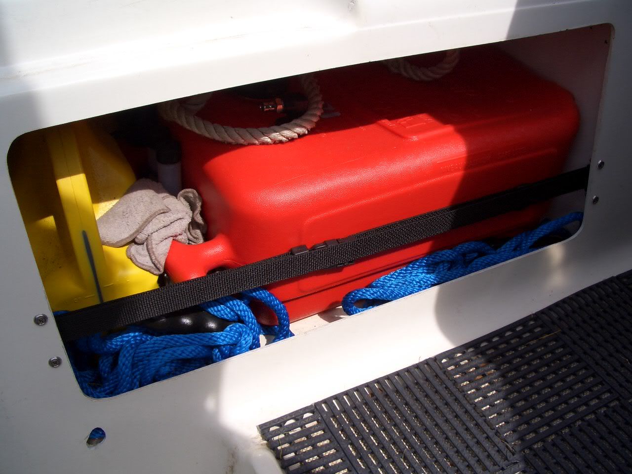

I have four 6 1/2 gallon Merc, tanks that fit nice & tight & do not come into the cockpit floor of my M & one hose that I switch from tank to tank, also keep a spare fuel hose in the boat incase of a fuel line failure like the prime bulb cracking or leaking

I've been wondering about getting four 6½-gallon tanks ... but I keep on coming back to the question:
"When (and why) would I need 26 gallons of fuel? That's - what? All day at full throttle?"
But for those who do need that much fuel, Bass Pro Shops (http://www.basspro.com) have the 6½-gallon "Neptune" tanks, that were mentioned in "Converting to Tempo Valu 6 Fuel Tanks" some years ago, at $30 each:
(These are in ALX357's 26X. Two starboard, one to port - he's got the "rule of thirds" built into his fuel system!
To me, the advantage of a 6½-gallon tank is that you can remove it easily and carry it to a gas station for filling.
I refilled one tank for the first time this summer, week before last - but I chiefly use the motor to get in and out of Cadle Creek. If I were doing a lot more cruising under power, I'd probably buy the Neptune tanks.

Bossa Nova has two 6½-gallon tanks - one port, one starboard. The rest of the fuel-tank area is for open-air storage of things I want abovedecks, such as docklines - or don't want belowdecks, such as butane bottles for my stove.
