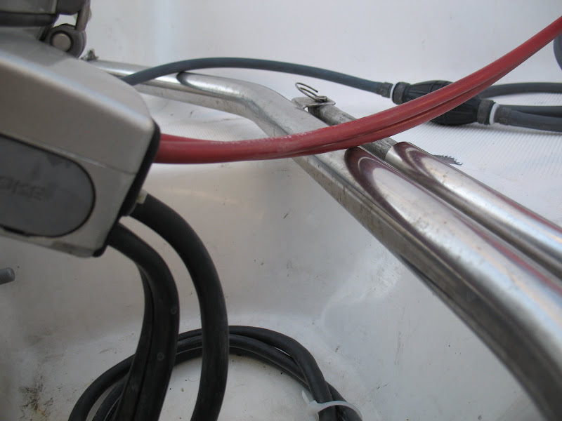

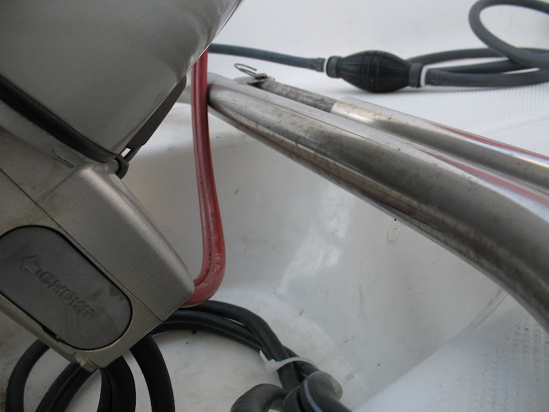

Opie wrote:
I don't have a clue, so here are pictures of my Honda 50, both down and up. Is this the same as everyone else's? I have not had a problem, and from the pictures, I don't see one happening.I think we all are reasonably satisfied with our Honda's, but does the M have the same design as the X where the two cables get bent sideways on the steering bar when the motor is raised?

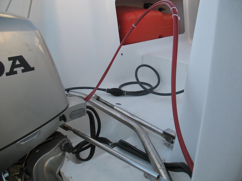

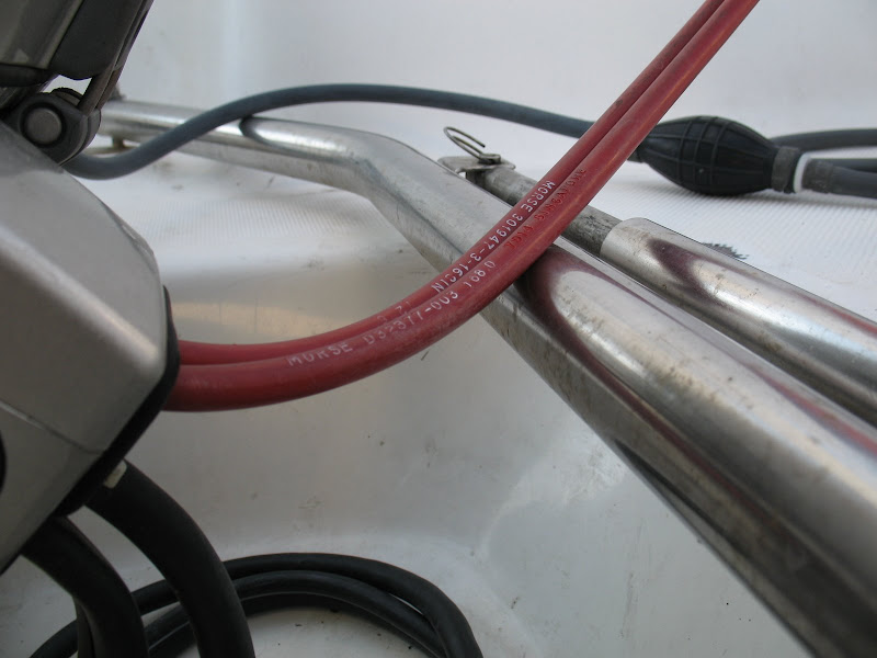

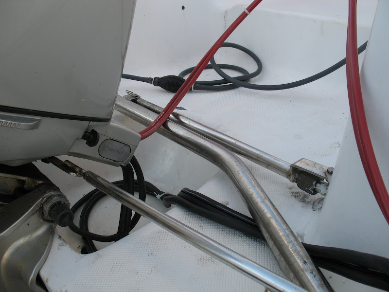

I found some pics I took a couple of years ago, before the obvious extreme stress broke one of the cables.

Does anyone have any photos showing what they believe to be properly bent cables for an M
I am not certain whether you were asking, or telling me that the cables are too bent. I don't think they are.
No, and no!seem hard to shift? throttle have lots of resistance?

Re: Honda 50 HP problem
I was making an observation before based on the photo.
A two foot round bend is what my installation manual says, ideally would be a straight run.
opie pix's looks right except a little more loop than needed. But you can see the extreme bend when the motor is tilted up at the steering bar.
opie are those cables now run under the steering?
My new cables are run in a loop all the way to the back of the "M" motor well in a loop. The Honda also has the cables enter the opposite side of the engine then mine too.
I dont think you can get away with not kinking the cables some what. But from the pix of the x transom it looks like the less kinking would be under the steering. The loop Michael shows looks ok, doesnt look kinked at all at full tilt and it doesnt look like they would have any kink at full down either. Sort have to play with it I guess. Seems ideal if the cables come out of the boat on the opposite side of where they attach to the engine. all my motors the cables enter the left side of the motor, looks like Honda, the shifter and the throttle are on the right. In the case of the "M" the cables come out of the left side of the boat.
What Michael did, or has, is like mine on the "M", cross over loop. His idea of the split plastic tubing over the cable keeps the cable from chafing, but hides potential problems if the cable cracks. So feeling a tight shift and throttle will alert us of cables that start to wear. I got 23 years out of cables on the whaler with that plastic split tube over the cables, the sun and the wear from friction was almost eliminated.
Although the plastic tube was replaced a few times as it rots over time. Same thing would have happened to the cable plastic if it wasnt protected.
Opie the kink you show in your pix, would certainly accelerate cable failure in a much shorter time than normal. Especially if you sail with the motor tilted up, and the engine moves with the rudders. Not only is there an extreme bend in the cable, which would flex and possibly break the metal wrap inside the cable, but you have a constant wear point from the steering bar. It looks like if you went under the bar and put the plastic split tube on, you would be ok.
It also looks like the bar is rubbing on the wires going to the motor, over time it could rub through, and short out the motor. There again plastic split tubing could save the day for you. Besides shorting, those are battery cables too, you could have a fire if that shorts out.
Mike

- aya16
- Posts: 1362
Aft on yours it looks as though that a full turn to the left would pull on the cables and have even more kink, a few more inches of slack would loosen up your steering some. Im guessing but it looks as though your wires and cables pull in and out of the boat as you turn. If they dont then what could happen on yours is the holder for the shift cables inside your engine is getting a lot of stress, on my older merc, that holder is plastic. I dont know what honda uses.
I got 23 years from cables on the whaler and they still look and work like new, but the whaler cables had no stress, a long loop, and was protected from a split tube. Your cables look ok, except the loop, and if the cables pull in and out of the boat then theres probably not much stress on them anyway. But you do have an area that will leak water into the boat onto the bed. My through hull boot is zipped tied around a plastic tube to make it water tight as possible.
Im not telling any one how to rig their boat, just observation on the pix I see.
cables rarely just fail, it takes time and they go slowly, shifting and the throttle get stiffer before they break or freeze up. Problem is over time we get used to the friction and feel its normal. The shifter and throttle should be smooth as glass if the cables are installed right and the friction screw on the throttle handle is adjusted right.
Just a guess and to make it fun, I would guess that when your cables do fail (many years from now) it starts with the plastic coating on the end of the cable coming loose from the end of the metal flange at the engine side, the cables will still work but will have more slack and the wrap metal inside the cable will separate and pull apart,(stretch). The cables will still work, but you wont get full throttle and the shifting will be sloppy.
