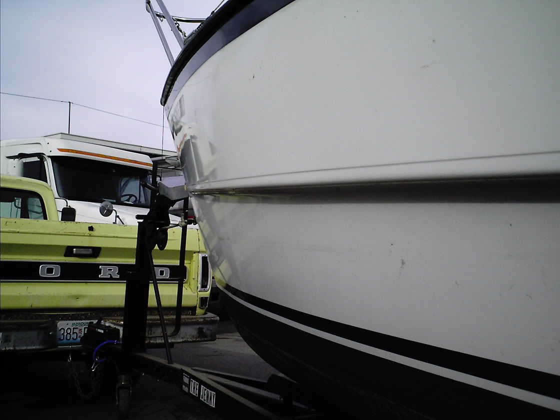

Notice the dreaded void between the bow and the v-block.
I have towed my boat quite a few miles in the 8 years Ive owned it. The ramp at our lake is very steep and you CANNOT get the boat to bunk forward into the v- block.
I tried the "Mac-bump" one time and had all 4 corners of the "Tow Monster" barking. The only thing I succeeded in doing was striping the road.
Granted my trailer is a dual axle and perhaps tows better than a single but the first 3 years we owned the boat it was still a single. I towed the boat every mile I pulled it with about an 8 inch gap.
I pose the question, "does 6 or 8 inches on the trailer location really make a discernable difference? In my mind the answer would have to be , no. Im sure the engineers on the site will educate me as to the reason my thinking is flawed.

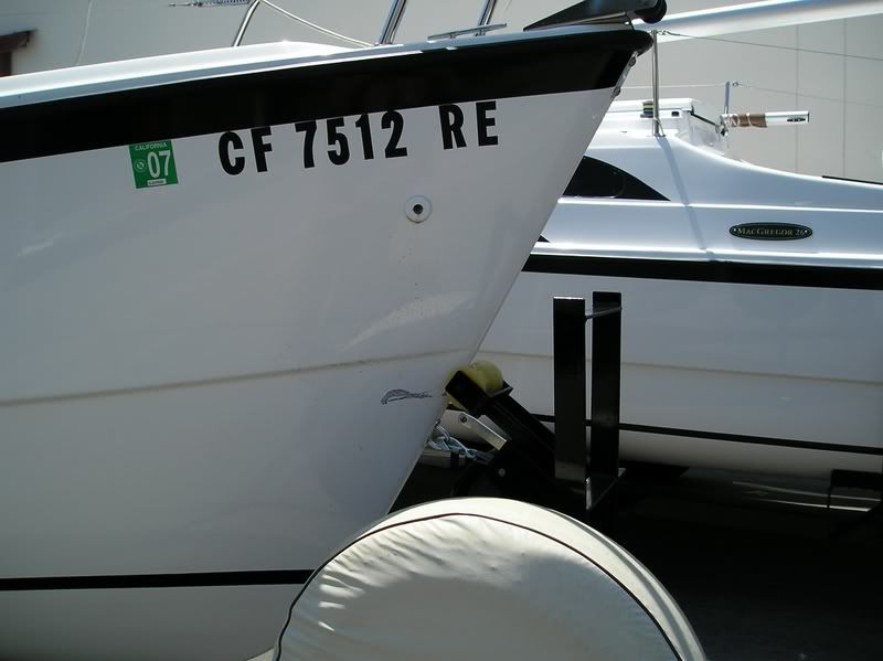

I was unfortunate enough to get a trailer with no bow guides and ended up with hull damage. I returned to the factory for a patch job and bow guide installation. If they give you a trailer without this critical feature get it added. My damage was minor but yours might not be.

I did it on a very steep downhill to no avail.It REALLY helps if you can find a location where you are going downhill, (even slightly), when you do the "Macgregor Bump"!
Those scratches are testament as to why you should walk your boat onto he trailer whenever possible. That and powering on is illegal at most ramps.
