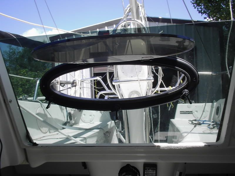

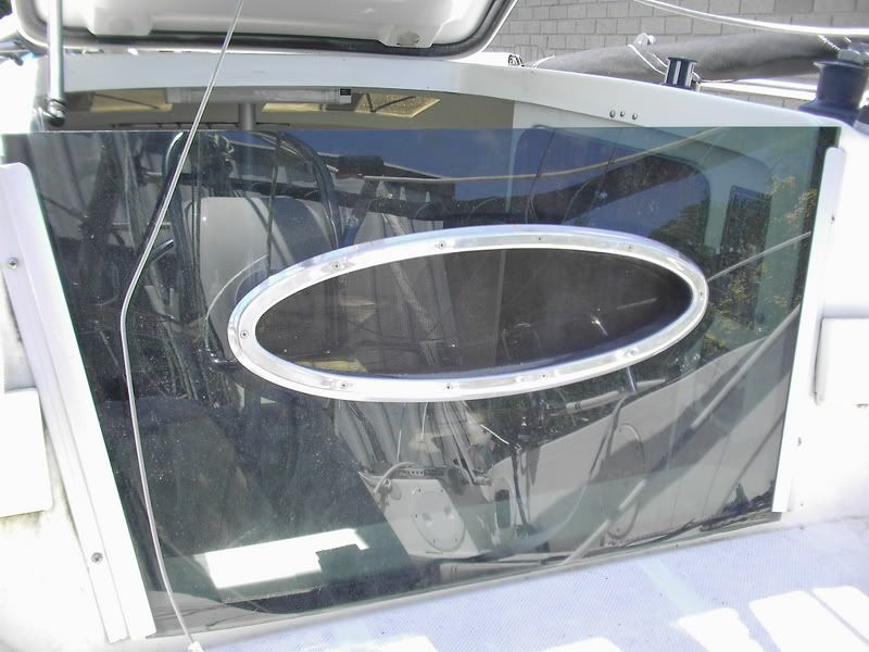

1/4" smoked lexan hatch entrance with opening port ligh
viewed from the inside
Cheers John
Posts: 6294
That's a very nice job, John.
I may steal your idea shamelessly.
Posts: 6795
Beautiful John, just beautiful :!:
I saw your hatch entrance from the outside in another photo and was wondering what it looked like from the other side........Great Job.
Idle Time
Posts: 434
Joined: Sat Jan 31, 2004 4:28 am
Post by Idle Time »
we put clear hatches in ours....but that doesnt leave for much airflow...great idea.
Bransher
Posts: 217
Joined: Fri Sep 22, 2006 2:07 pm
Location: Central Florida - 07 26M w/50 hp Suzuki.
Post by Bransher »
I had considered making something with louvers for ventilation while keeping out the rain. But it would probably be more labor intensive. I really like the looks of your mod., both inside and out, and the smoked lexan still gives you some privacy. One question…………..how much “flex” does the ¼ inch lexan have? Is it rigid enough?
Thanks.
Bransher
The 1/4 is as strong as the original which is strong in the middle but weak in the edges about 1/8" If I ever have to replace it I would go with 3/8" if avail. as my slot would allow it to fit
cheers John
more pic's with the portlight open
from the outside
Cheers John
