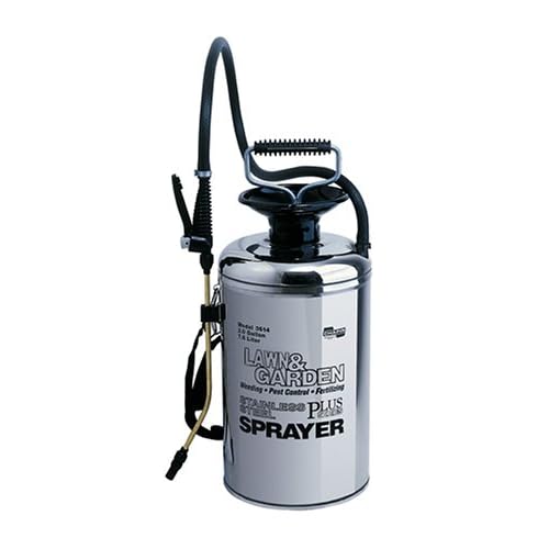

I'm thinking an ordinary garden spayer - perhaps a stainless one* - mounted to the trailer frame, and the output going to a valve, then into two lines, each leading aft to a brake, with a nozzle on the end of them that is fixed to the frame and directed to aim at the brakes. Before you leave home you fill the sucker with water, then once you've launched (or recovered) just pump it up, hit the valve and you're good to go.
There's money to be made in selling a kit like that!
(* Maybe use a standard 2-gallon sprayer, as below left, or even one of those Zodi shower tanks as seen on the right... I like the Zodi idea 'cause it holds much more.)
