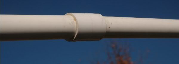

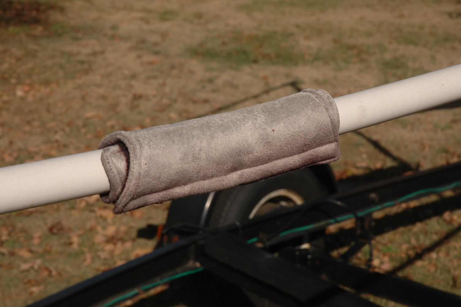

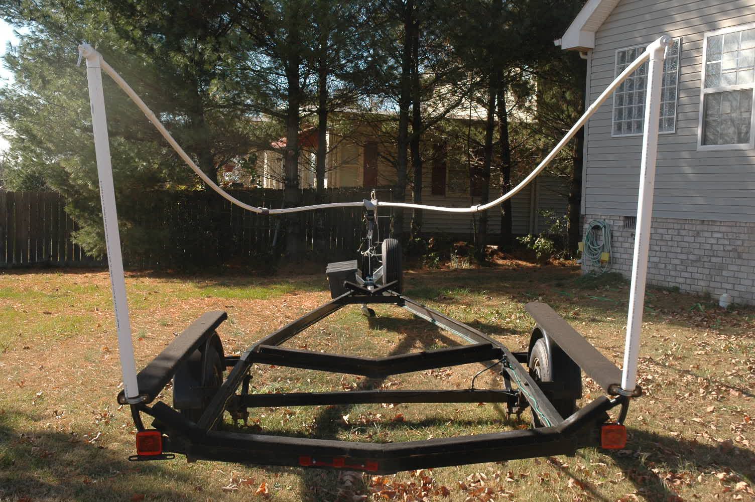

PVC pipes, slid over the goalposts, and over the horizontal guide bars, with heavy rope inside. Tied off at rear thru hole in end cap with stop-knot. At front, line goes thru both PVC and hollow steel rod, tied to ladder. Not alot of sophistication, but is is accessible and can be replaced easily. Regular coupling joints used, takes 2-1/2 pipes per side, one coupling high and out of the way, the other, covered by a Walgreens automotive shelf seat-belt shoulder velcro-closed pad.
THe rope adds strength, and allows only a bit of stretch, while a second rope is tied to the cut T on the forward end of the pipe at the bow to keep the PVC pulled tight. IF the boat hits the pipe sideways, it will give a bit and not bend the upright goalposts, though the front guides may get bent outward a bit, not on the pipes themselves, but the steel plate at the side of the rubber V-block.
Also visible is the pair of 2x6 pressure treated side boards attached from the base of the goal-posts with galvanized straps, to the fender tops with a carriage bolt from the bottom of the fender up into the 2x6 which has been wrapped with in/outdoor carpet and stapled on the outboard side, and has counter-sunk nyloc nuts on the cut bolts, so that nothing metal projects above the top surface. Keeps the boat from hitting the trailer fender, keeps it centered on the trailer, and provides a step for seeing/reaching into the cockpit from the side, ( if you don't over-do it and bend the fender mounts down.)

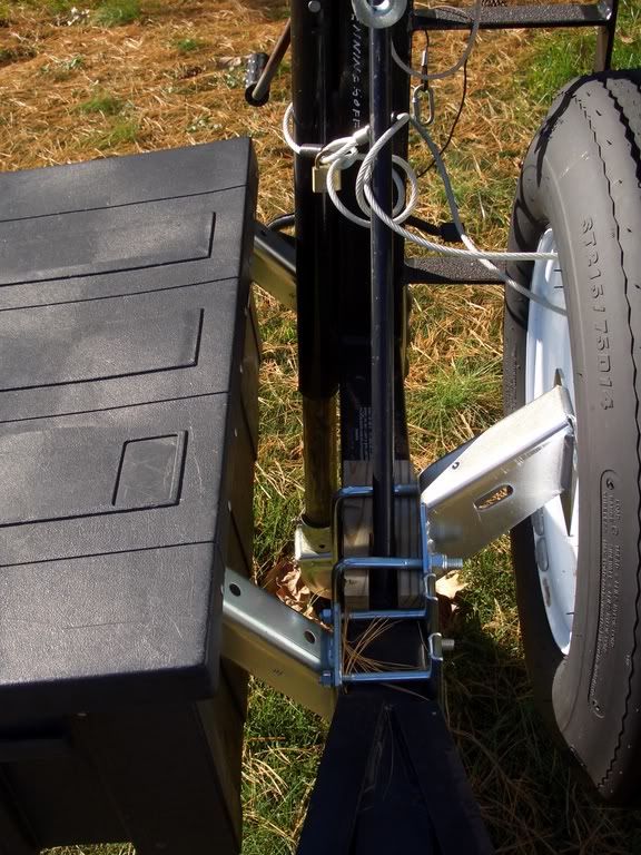

on an unrelated subject, the photos show a toolbox attached on spare tire mounts along with a spare hub and tire. The three heavy steel tire mounts and the box with hydraulic floor jack, jackstands, hydraulic bottle jack, and what-not else, has the dual function of not only being a convenient place to store that stuff, but adds enough weight on the tongue of the trailer to minimize sway.
